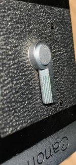

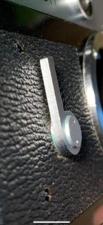

Hi,
I recently picked up a Canon P for not too much. The only problem is there seems to be some sort of blue/green corrosion on the overall exterior.
I've done some digging and come to the conclusion that it is verdigris. Now, I know I can send it to a shop (made a recent thread about that on this forum) to have it removed, but I'm curious about the long-term effects of it. Does verdigris ever come back?
My understanding is that verdigris is caused by the underlying brass being exposed to moisture/air. If the verdigris is wiped off (some say to use Brasso), won't the brass just be exposed to air? And if the conditions are right, won't the verdigris simply form again?
I've attached some photos of the body. I'm also wondering how deep this verdigris goes and if I'm better off finding another user body.
Thanks in advance!

Verdigris can also form where a camera's metal has been in contact with case leather that has been treated with some kind of chemical-bearing oils or waxes. That may not be the issue with your camera. BTW, I have seen far worse cases of this problem.
That’s a very mild case. I’ve seen far worse cases where it has been caused by sweat, either from hands, face, even eyebrows, can eat away at the surface. I have a camera or two like that. Once cleaned off, it hasn’t come back and no further deterioration occurred.
Thanks for the help everyone. I think I'm going to send it in for a CLA and note it down as something I want cleaned off. Once it's gone - I hope it won't come back.
Cheers!
Very mild case indeed, nothing to worry. At first I thought you were talking about a level of corrosion that could indicate the camera had been exposed to moisture and the insides might be rotten. Even in that case, the verdigris on the outside would not be worrisome in itself.
