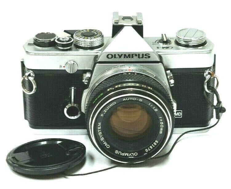

Olympus OM-1MD with 50mm f/1.8 F. Zuiko lens, MD logo on rewind side.
Olympus OM-1MD: In 1974 Olympus brought forth the OM-1MD, which, as its name implies, is an OM-1 that accepts an Olympus motor drive directly without requiring any modifications. This version usually has a small “MD” on the front and a small slot with a circular cover on the bottom that covers the motor drive coupling. The MD logo is located on the front of the body, either as a small plastic escutcheon near the bottom on the rewind side of the camera, or a sticker placed higher up on the other side, directly below the shutter release. Sometimes the MD logo is absent entirely, either because it fell off or was never applied at the factory. Bottom line: At prices generally ranging from $100-275 depending on lens and condition, the OM-1MD is a good choice for OM-1 lovers that require motor drive compatibility, but the OM-1n may be even better. But remember, when it comes to buying user-collectible classics, functionality and condition are everything—the specific model is less important so long as it has the features you need.
