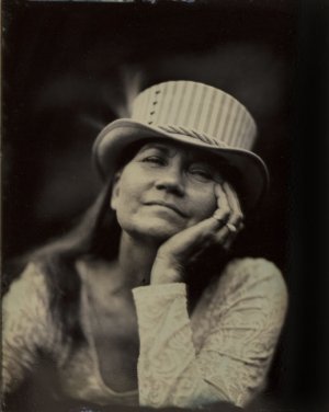

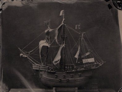

It’s difficult to talk in my samples but the ship was shot with my Wollensak Vesta Portrait and the portrait of my wife was with a Darlot Petzval from around 1860. Both lenses are large and to give you an idea the Darlot barely fits on a 6” lens board on my 8x10 Deardorff and is about as heavy as it can support.

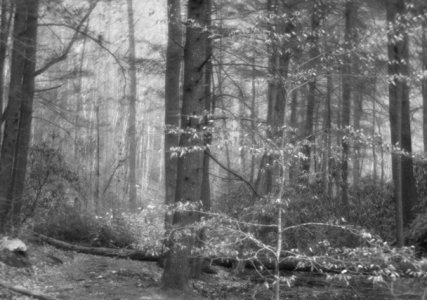

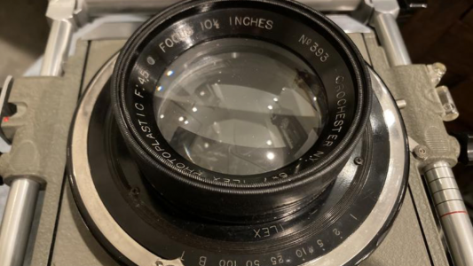

Here’s the Ilex Photoplastic Extreme Soft that I own and a landscape made with it.

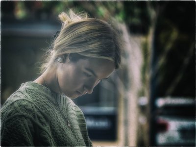

I still cannot get any joy with my Flickr account but this first image is one from my PC that was made with the Schneider tele Xenar 105mm f3.5. Its rendering here is typical of the rendering of these lenses. Personally, I really like the way it "draws" its images.

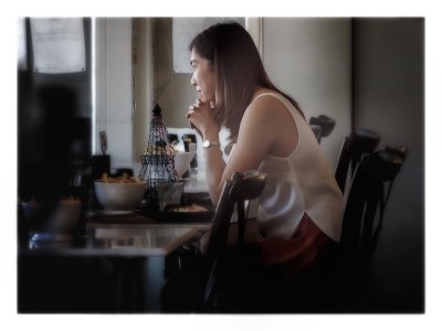

The second image was made with another lens I especially like - the Canon FD chrome nose 100mm f2.8. This photo was post processed a bit more than the first but it nevertheless shows what it is capable of in the "painterly" department.
