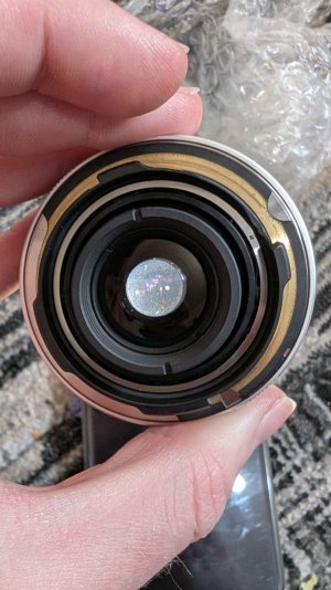

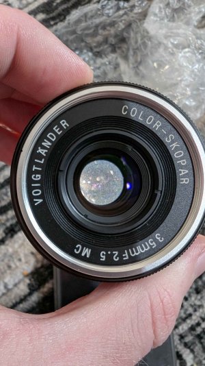

Hi all, I just picked up a Color Skopar 35mm Pancake I with the screw mount thread from eBay. In my late night purchase I failed to notice that it was listed as having 'light haze' - despite also being described as 'near mint' - which then lead me to discovering the cement haze issue with these lenses.
For context this was my first Leica compatible lens that I purchased as a Christmas present to myself along with a Canon L1. I've taken a look at it, just to the naked eye it looks perfect, but shine a torch through it and there is some haze, though I'm unsure how bad it is. I intend to take it into a couple local shops to get it inspected for a second opinion but thought I might drop it in here as well.
The seller has a 30 days no questions asked return policy so the only real loss will be in shipping costs, frustrating but bearable.
Thoughts? Will it perform adequately as is, is it worse than described or should I just bite the bullet and return it?

You have to pay attention for what you are doing. Late night purchases, titles and photos.
On title it is f2.2 lens, which non-exist.
Of photo it is shows optics loaded with fungus. Looks like you used fluffy pad as the background...
I don't think title is editable, but photos are re-takeble.
Get compact flash light, turn it on, put it behind the lens, not in front. Move lens to different angles, rotations until flashlight will expose all of the optical elements and what is beside, on and in-between.
My experience with the cement haze issue on older Voigtlanders is that it increases with time, and that repair is not possible or prohibitively expensive. Of course, I can't say whether the haze issue with your lens is with the cement, or is something accessible on an element surface. Even then, repair can be expensive. My experience is also that a little haze has negligible effect on 99% of photographs. Nevertheless, this lens is not rare; I'd send it back and shop (carefully!) for another.

Thanks for the advice everyone, even from you Ko.fe, though I don't think the life advice about being more careful based on a couple of mistakes are warranted. For what it's worth I did take the photo with a compact flash light in front of the lens.
Yes this is the 35mm / f2.5. I'm currently on my way to some local camera shops to have a closer look but it's likely I'll return it. I paid about $450aud before shipping so it wasn't exactly a steal. I bought it for shooting street so contrast and sharpness are important to me.

Spoke to two different people at some local stores, they both said it was more than 'light' haze. Made a return request with eBay so I'll be getting my money back. One of the shops has second hand Ultron 35mm/f1.7 on the LTM mount, I might grab it though it is noticeably more expensive. Thankyou all for your advice, I'm grateful.
