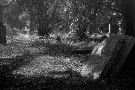

I just got my first roll of Adox CHS 100 II back from the lab (I sent that one out - my darkroom is out of use for a bit), and I'm really impressed with that. Don't know what developer they used but I'm looking forward to developing it myself:
