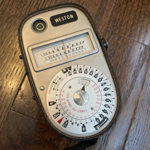

Weston Ranger 9 by Vince Lupo, on Flickr
Fortunately I already had two of the MR-9 battery adapters and this meter is right on the money. The only thing that I don't have for it is the incident cover, but I think I can suffer without it.

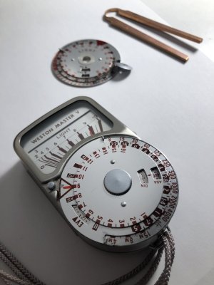

Here’s a photo of my hybrid V. As I recall the dial from the Euro directly fit the V. I believe I swapped the screw that secures it but basically they’re the same. I do remember I’m pretty sure I didn’t have to make any modifications.Hello- I have a Master V in perfect working order and a water damaged Euromaster in not so working order. I noticed you replaced the Master V dial with one from a Euromaster which is something wanted to do as well but unlike the Master V, the Euromaster has a slightly different method of affixing itself to the body. There Is a light grey “plug” at it’s center(possibly covering a screw) unlike the Master V which is knurled. How did you go about removing the dial?
The Euromaster dial is a huge improvement imo.

Thanks X-Ray! Success! Removed the thin cover screw with a spanner similar to the one in the photo with great difficulty.Here’s a photo of my hybrid V. As I recall the dial from the Euro directly fit the V. I believe I swapped the screw that secures it but basically they’re the same. I do remember I’m pretty sure I didn’t have to make any modifications.
