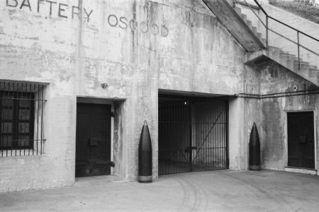

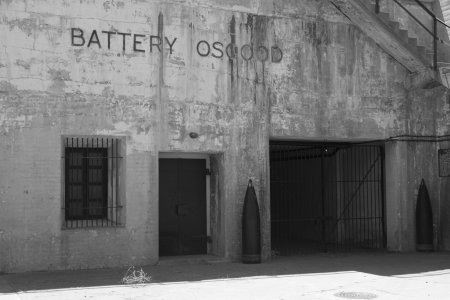

It's not so hard - even with these examples. IIRC, the film was Ilford FP4. I only chose these two images because they were the same subject taken at almost the same spot. The digital image captured far more detail on the concrete surfaces. IMHO, the (2nd) digital image is far superior with better tones and higher contrast without sacrificing detail.
I believe your observation about scanning is a valid one, but there is no other way to post film images on forums such as this. The original scan is a high resolution TIF file (64 megabytes) - then converted to JPG.
I gotta disagree, it looks highly artificial to me and I suspect there's quite a bit of local image manipulation going on that makes it look so. Yes, all the detail is higher in contrast, but that's not a good thing necessarily. Apart from looking unnatural this also often robs an image of calmer areas and if everything is emphasized, nothing is. The film scan is a bit washed out in the highlights but otherwise much easier on the eyes.

Alright. The original images posted on page 1 of this thread were processed in order to get as much detail as possible from each file. The above images are both unprocessed (the 2nd image was converted to B&W only). They are more similar this way, but the first group demonstrates how much information can be pulled (or not) from the original files.
To my eyes the (2nd) digital image above looks similar to the processed film image on page 1, but with less contrast.
