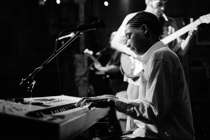

Neopan400 (or maybe HP5) with normal processing. Exposure and development determined in 2-3 seconds per the preceding post. I knew I would be shooting wide open or f2. I knew my exposure would be 1/15th since I can hand hold that, he usually held his head still, and any motion blur would be in his hands and fingers which was acceptable. One meter reading, straight on the front of his face, showed iso 800. But I knew one stop underexposure would do nothing detrimental to his face and would even help drop out more of the background to total black which would help give some contrast to his skin tone.
