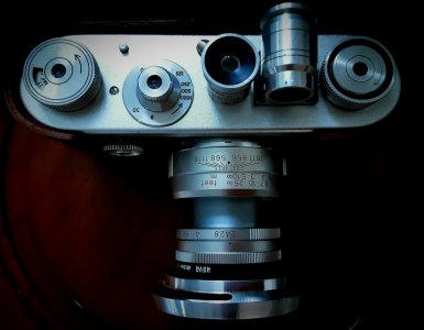

With semi-fisheye lenses like the Zeiss 16mm/f2.8 or Leica 15/2.8, zone focussing is most always spot on from 1 metre to infinity. Other LTM type cameras like the Corfield Periflex, do away with the limits of the Leica III series and M series - it uses a periscope and can focus any SLR mounted lens precisely in addition to every screw thread lens of the correct LTM pitch, or non LTM pitch (Braun Paxette lenses), and even the Leica Valoy enlarger lenses using an adapter. Here's an image of the periscope.
