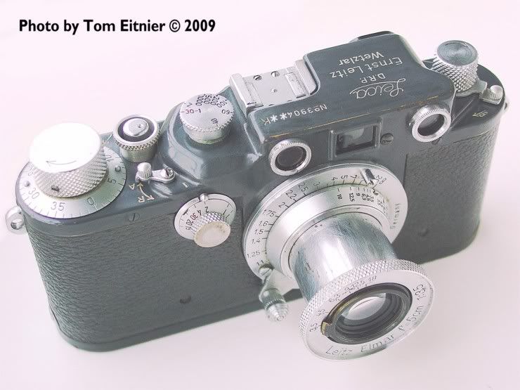

I just bought a 45' IIIC K Grey that has some paint issues, it`s a dirty camera that`s going to have a full CLA etc. etc. and it will be a "user" not a china cabinet collectable........
I need some suggestions on the proper cleaning and if there`s any way to "freshen" up the look of this top plate without damaging the paint
(a gentle high grade car polish for lacquer jobs?)
I have done the traditional isopropyl alcohol on it already to remove dust and grime and the paint just looks flat and dirty, what can be done to bring some life to it and also preserve the paint as well, while it will be one of my "user" cameras.

When you say your paint is dull and flat, do you mean oxidized and rough? If so, you really need to use polishing compound on it, to get rid of the oxidization. You can't polish sandpaper. Only after that can you wax it, if you want to. Any good untinted automotive wax, with a hard finish, that you buff to a shine, is good -- Simonize, Turtle Wax, Diamond-Hard, and etcetera. Blue Coral used to be great, until they changed their formula and ruined it.
Alternatively (again after using the polishing compound), there are chemical protectants that bind with the paint to make it more durable, like Star-Shine. It isn't Star-Shine's primary purpose (which is to make your paint hard as glass), but it makes paint shiny too.

Tom, I've had decent results with silicone spray - onto a rag, not directly on the camera - old toothbrushes (soft ones) and t-shirts. Leaves a lustre, not a shine.

My vintage guitar repair book says lighter fluid is the safest cleaner for nitro-cellulose finishes. I had a luthier tell me never to use silicone on nitro finishes. I wouldn't put anything on it, like wax. It just ends up being crud in the long run, and has a sticky feel.
I think a black or grey nitro finish, without a clear coat, is naturally going to show fingerprints etc. It's the polyester finishes that have the "bowling ball" gloss.
I apply machine oil and then wipe it off. I use this to clean chrome cameras as well. I only know very very few paints it will damage, and over time you learn to recognize them.
Novus plastic polish #2 will do an acceptable job of cleaning/shining the paint on my black Nikon F2. It is used to put the final polish on clear acrylic plastics like aircraft windows etc. It removes just a tiny bit of paint and adds a small amount of hard wax.
I apply with my fingers, rubbing carefully then remove and buff lightly with a cotton cloth. Works quite well.

Well, the Leica Grey paint is a Luftwaffen Color that was used in the interiors of Aircraft and also towards the end of the war as camo on the outside of the aircraft as well, I`m pretty sure that it was NITRO-LACK and it`s a semi-gloss looking paint, not shiny, but also not dull, it has a certain "sheen" to it.
(and well some "old timer" Grey collectors still say there`s two different tones of the RLM paint they used, but my 1943' and my "other" 45' IIIC K pretty much match shades, and they were made two years apart from one another).
I think I`m going to have Youxin try a jeweler's rouge on the camera before he puts it back together, as I`m not 100% sure, this camera`s very odd, the paint looks original but then it also looks like it was "treated" before somehow?
The collector who owned this camera, also had a 1957 Leica MP BLack "refinished" by Leitz in the 1970`s (totally ruined it`s resale value) so I would`nt have put it past him to have tampered with this paint as well, it`s well really hard to tell either way, and I`ll be glad to have this one back, as it`s going to be a fun user. 😀
