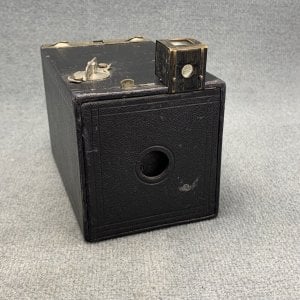

Original Kodak Brownie of 1900 with rare accessory clip-on viewfinder. Camera sold for only $1.00; the viewfinder was 25 cents extra!
Despite its spartan simplicity, ample price, and the inconvenience of having to return the camera for processing, the Kodak was a phenomenal success—about 25,000 were sold in the first year of production—because it was the first camera that enabled anyone to take pictures, and it was aggressively marketed with a brilliant advertising campaign. Eastman’s astute grasp of human psychology and motivation is evident in these quotes from an1888 Kodak ad, “Anybody who can wind a watch can use the Kodak Camera…No tripod, no focusing, no adjustment whatever…A picturesque diary of your trip…may be obtained without trouble that will be worth a hundred times its cost in after years.” In 1889, it was “1. Pull the cord 2. Turn the key 3. Press the button. And so on for 100 pictures.” This was later refined into the greatest photographic advertising slogan of all time, “You press the button, we do the rest.”

The original Kodak Brownie: Still no viewfinder!
Now you would think that 12 years would be sufficient for Kodak to develop a box camera with a real viewfinder, but no. Like the Kodak of 1888, the original Kodak Brownie of 1900 had no viewfinder, only framing lines in a 60° V-pattern inscribed on its top, with the open end of the V pointing forward toward the subject. However, it was a simple, competent, easy-to-use, daylight-loadable camera at the then-unprecedented price of $1.00. And by putting a brilliantly conceived mass-marketing program behind it, Kodak was literally able to motivate millions to buy it. The Brownie’s success was unprecedented—in the first year alone, over 150,000 cameras were shipped, three times the previous record. To get a clearer idea of the impact of the Brownie, check out one of the many timelines of the 20th century and go to the year 1900. Right up there, along with such momentous events as Max Planck’s formulation of the quantum theory and the publication of Sigmund Freud’s “The Interpretation of Dreams” is Kodak’s introduction of the $1 Brownie camera!
The Brownie got its name from artist Palmer Cox’s whimsical cartoon versions of Brownies--“hard-working Scottish sprites or elves who did household chores” --that were as popular in the 1880-1920 period as Mickey Mouse is today. Some have conjectured that the name was an oblique tribute to Frank A. Brownell, who was responsible for its design and manufacture, but this is not the case. In any event, the Brownie is about as simple and basic as a camera can get—an imitation-leather covered cardboard box, with wooden film carrier, measuring about 3 x 3 x 5 inches. It has a simple fixed-focus f/11 meniscus lens, and metal rotary shutter with a single speed of about 1/35-1/50 sec plus T. However, starting in July 1900, a small clip-on accessory reflex viewfinder was offered for 25 cents! The film-winding key was detachable and often lost, which is why many original Brownies are found with soldered-on, non-standard keys. The first 15,000 Brownies were fitted with a push-on cardboard box lid back that proved unreliable and was soon replaced (March 1900) with a bottom-hinged back with a nice, nickel-plated sliding latch on top. Despite its modest specs, the original Kodak Brownie did score one extremely important historical distinction—it pioneered No.117 film, thus making it the world’s first 2-1/4 x 2-1/4-inch roll film camera. The117 size, essentially 6-exposures of 120 film on a narrower-flanged spool, is long defunct, but the glorious 2-1/4 square roll film format is still very much alive in 120-format. Also, that accessory viewfinder proved so popular that all subsequent Box Brownies had small built-in reflex viewfinders for composing pictures in horizontal or vertical orientations.
The Brownie was certainly the right product at the right time, at the right price with a catchy name. But what really transformed it into an enduring American icon that sired generations of Kodak Brownies up until the ‘70s and inspired countless imitators worldwide, was Kodak’s ingenious and aggressive marketing plan. Brownies were advertised in popular magazines rather than trade magazines. Ads stressed it could be “operated by any schoolboy or girl” and kids were urged to join The Brownie Camera Club, which had no initiation fee, and whose object was “to increase the interest of American boys and girls in matters pertaining to photography.” Kodak ran picture contests and awarded prizes. A roll of film, called a “Transparent-Film Cartridge, 6 exposures 2-1/4 x 2-1/4” cost 15 cents, a box of paper, 10 cents, and a Brownie Developing and Printing Outfit, 75 cents. At the bottom of many ads was a small box with the message “Send a dollar to your local Kodak Dealer for a Brownie Camera. If there is no dealer in your area, send us a dollar and we will ship the camera promptly.” With the arrival of the Brownie, anyone could take photographs of everything from special occasions to everyday life, and to do so inexpensively. The era of the snapshot had dawned, and the world would never be the same.

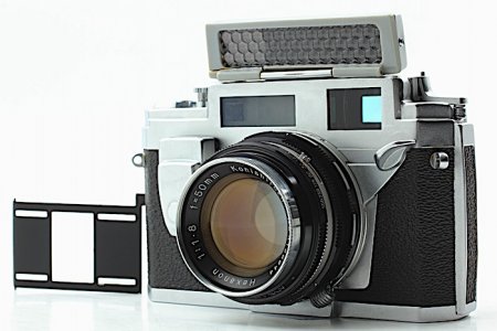

Konica IIIM of 1960 had a big ugly hinged selenium cell meter on top that's notoriously unreliable and (mostly) unrepairable. It's too bad, because the camera provided full and half-frame formats with parallax and field size correction and has a great 50mm f/1.8 Hexanon lens.
The Konica IIIM: A great camera destroyed by adding a horrible meter!
The beautifully made and attractive Konica IIIA of 1958 featured an unusual, vertically mounted, left-handed, rapid-wind lever, and a magnificent high magnification (1:1) range/viewfinder with true projected, parallax-compensating finder frame lines that also adjust for field frame size (the reduced angular coverage as you focus closer). Other features include: an excellent 50mm f/1.8 or f/2 Hexanon lens, Seikosha 1-1/500 sec MX shutter, rewind crank and self-timer. Despite its beautiful execution, elegant proportions, and advanced features, the Konica IIIA was a glorious technological dead end. The subsequent Konica IIIM (which added half frame capability and a coupled flip-up-selenium-cell meter) was an unreliable dud due to the fragile, unreliable meter call that also spoiled the handsome lines of the camera. About 95% of Konica IIIMs have non-functioning meters, and your chances of getting one repaired are slim to none. The solution: If you hanker for a great Konica rangefinder 35, look for a nice clean Konica IIIA; they’re readily available used in clean working condition for about $200-$250. It is said that the 50mm f/1.8 Hexanon lens performs a tad better than the 48mm f/2 but the latter is more compact and more in keeping with the camera’s elegant form factor. Either version is a fine user-collectible well worth the current price.
