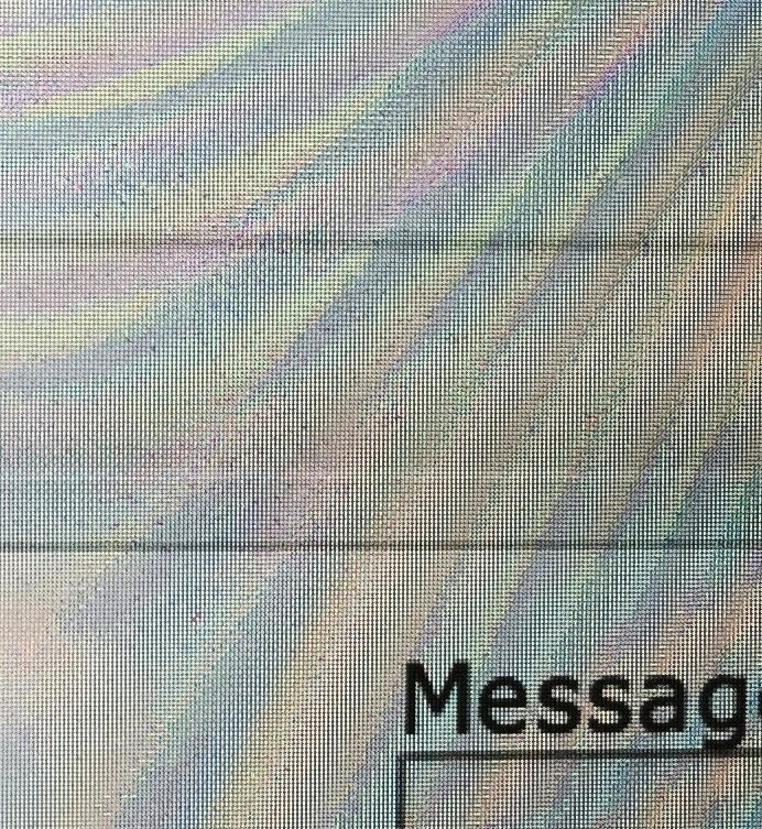

Look closely at your tablet or phone screen at 1:1 and you'll see the problem, screen shows a pattern of dots. And, you can get really wicked moire patterns (spacing of dots on screen vs spacing of pixels on sensor) like this:
