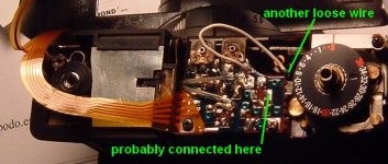

After soldering the loose wire at the battery compartment, the camera was still dead. I removed the top and immediately saw another loose wire😱.
A picture of the topless camera goes attached.
Not usual to have two distant unrelated loose connectons, the interior of the camera seems well preserved...
Another soldering job😕

Joao, that's really strange. But nothing to lose - it just should work. Etching to hear it works!
