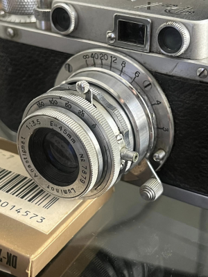

My father-in-law gifted me a week ago a Yamato Pax 35 RF camera he had used to take pics back during the Korean War.
Did some tweaking/tinkering with the unit, and found out the following:
  1. Lens focusing ring gets stuck after a while after cleaning with lighter fluid. Assum old grease/gunk.
  2. F/stops open and close fine; maybe requires some cleaning, as I am assuming that any grease it may have is old as hell.
  3. Lens Shutter - did not work. Got it to operate after major cleaning with lighter fluid. Again, I know this is a temporary solution, but hey, at least I know it works after opening up front element and cleaning.
  4. RF feature - I can adjust the lens, but I don't see any changes with the image in the rangefinder.

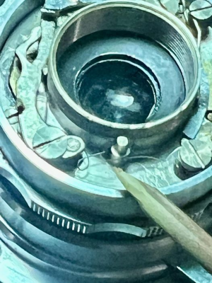

  5. I know for a fact that there is a snapped wire/spring in the lens that I am pretty sure that it assists in some way the shutter operation.

Started to work on it. Shutter is working beautiful at the moment, but the focusing ring… jeeeeeezzzzzz!!!! Gunk/crud all the way. Will have to disassemble.
Also, opened the 2 front and 1 rear “windows” for the rangefinder. A little brush with a bit of alcohol, and a bit of lens cleaner. EVERYTHING so bright now in there, and the actual alignment images work!!!
Stoked, to say the least. The lens focusing ring is the one that worries me the most. Will definitely remove the complete lens assembly to see if the ring can be dismounted, cleaned and lubed for install.
Will advise when a roll is finally ready for shooting!!! 🙏🙏🙏👏👏👏
Quick update... have the rangefinder function finally operational, shutter working, cleaned body inside and outside... but (there's always one, right?)...
I dismounted the les from the body, and started to clean the elements... no problem here. My issue is the helicoid... I removed all of the gunk/crud/dried grease as best as I could without dismantling the unit, as I know that there's a catch related to alignment when disassembling/assembly.
I am here at the moment... almost a clean helicoid up to where I could reach.. I know I have to get some additional work done, but not sure on much further to proceed. I would greatly appreciate some feedback / tips/ hints or links.
Pics below... all of the black specs are "grease crumbles"... no idea when this might have been serviced. Softened it up with lighter fluid.
Also, need to adjust the Bulb setting... even when fully depressed, it opens and closes as a regular pic shutter release. Any idea on what to set?
