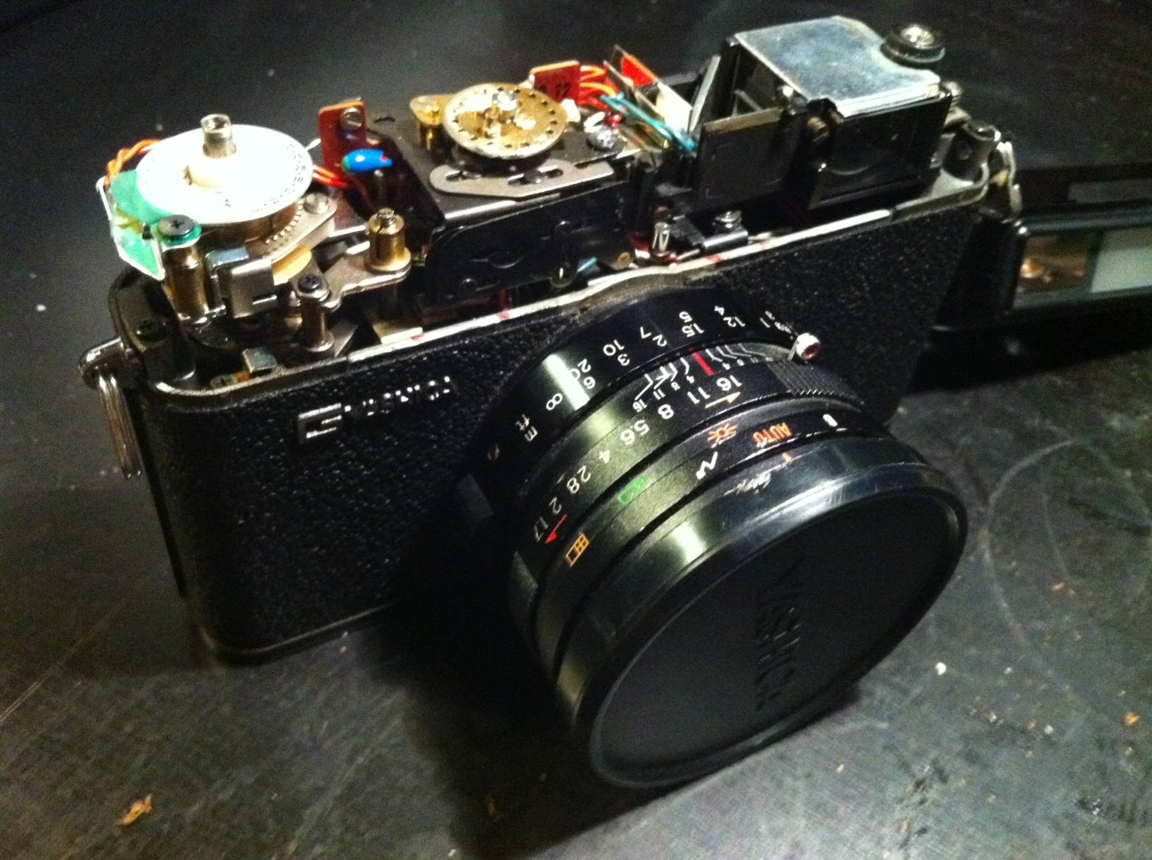

I recently tried to shoot a local fashion contest thing with my GSN...
It should be warned that.
1. If you are in a room that has extremely white modern lighting you will get almost no ghost image to line up because of the natural yellow tint to it (halogens provide a lot of what you need).
2. You get even less of a ghost if you turn the camera vertical. If you play around you can improve it a little by placing your eye correctly but still get very little.
Solutions?:
Cut the glass off that is in front of the magnification glass piece. Then apply the black dot trick. I even bought special pens that you can apply black with to glass or remove it with the other solvent.
Anyone got any thoughts?
Too much effort for a GSN?

Getting to the rangefinder itself is very easy on these cameras with nothing more needed than a screwdriver and a pair of pointy tweezers to undo the screw on the shutter speed dial.
Now I'm gonna have to try the black dot trick to see why it doesn't work.
Can I ask, are you starting with a perfectly clean finder? Have you removed the tin lid on the beamsplitter (separate the glue with a sharp blade) and cleaned your glass and beam splitter?
Edit: Seems Keith was thinking the same thing as I wrote that. And the beam splitter is something you clean at your own risk. I had some very mild lens cleaning solution so I used that and it did not harm it but again be confident or accepting of responsibility of damage if you try to clean the beam splitter coating.

Cleaning the rangefinders on the old Electros is not difficult, you just need a pointed lens spanner, or a pair of tweezers with sharp points to remove the ASA dial on the top of the camera. The only other tool you need is a Philips screw driver.
If you remove the top cover to the camera, you can clean out the insides of the glass windows on the cover, and the outside glass on the front and rear of the viewfinder. If there is dust or crud on the inside, you can remove the sheet metal cover which is held onto the top of the rangefinder by a couple drops of glue.
You can use a Q-tip and a blower to remove dust and dirt. You can wet the Q-tip with lens cleaning fluid to clean the insides of the front and rear lenses of the viewfinder, but I don't recommend using wet Q-tips on the mirrors; the coating tends to come off easily.
There is a small mirror to the right side of the rangefinder, somewhat below the exposure lights. This mirror often gets dusty, and if so, contrast can be reduced. Clean this mirror with a dry, or slightly wet Q-tip.
The black dot works a little bit. The primary reason why it does not is the fact that there is the glass and then the magnifier lens. Too much light gets in-between them. You can see the effect but it is nothing like on cameras that lack the double glass where it becomes no image at all out of focus.

Just wondering why you don't pop the top off the camera as the front protector glass comes off with the top cover then put your black dot on the magnifier glass and then reassemble the top. Am I missing something with that idea?
