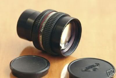

I'll post a few photos of ones (makes/brands, not focal length) that I considered quite good.
A particular favorite (for 35mm) of mine were those 63mm Nikon's, even the early ones are very good - bottom pic.
