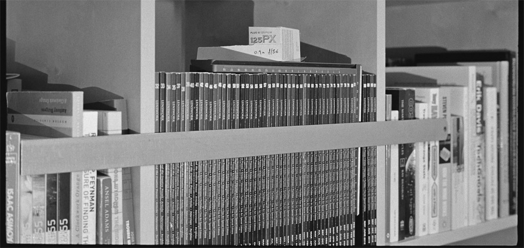

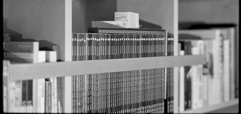

It was raining all day, so I thought I would do a test with the new lens I got from Santa - S/N 156032XX and PlusX M6x0.85.
All at 0.9m - the focus should be on issue 60 - the 10cm mark on the metal plate and the corner of the film box.
The scans are of the whole frame including rebate, but I lopped off the top third to save download time.
@f/1.5
@f/2.0
@f/2.8
@f/4.0
@f/5.6
@f/8.0
At f/1.5 the focus is to the front - issue 54
It looks like mine if optimal at f/2.0-2.8 - issue 58
At f/4 the focus has slipped a little back - issue 62
At f/5.6 is spot on issue 60.

mfogiel, thanks for the link : comparing with your results, it looks like my lens is notionally optimized for f/2.8, which is in contradiction to the popflash statement.
The lens has the newer bayonet with the machined recess ring.
It looks like it's a mystery how or if Zeiss have changed the lens over the years.

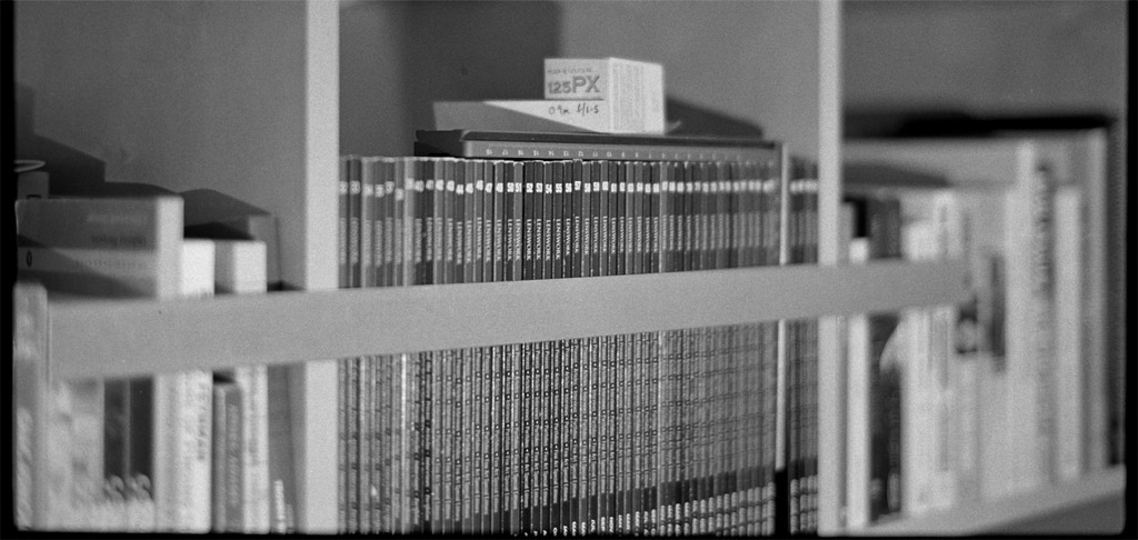

Here are the close in shots, which probably show more clearly the center of sharpness shifting backwards as the lens stops down.
@f/1.5
@f/2.0
@f/2.8
@f/4.0
@f/5.6
@f/8.0
Yours is obviously one of the older ones that came optimized for f2.8, like the one I have. Your test results looks similar to mine. I prefer the 2.8 version as it is more usable at commonly used apertures than the f1.5 version. I mostly use mine at f2.8-f8 and the focus is very good at all those apertures on mine.
