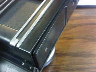

When the camera is open you find a thin black metal shield at the bottom hiding the flat release spring and also the tiny screws for tensioning the curtain springs. However it also hides the break for the second (closing) curtain. Check whether your plate has been bent inside thereby obstucting the break (the break is a tiny almost round disk that must be able to turn freely). If the break is obstructed the second (closing) curtain might not close at the right speed at certain shutterspeeds and this may lead to what might appear as a light leak. Hope this helps.
Below a picture of a Z4 that I recently CLA'd (and partly fixed) for a fellow member. The camera was in need of new light seals at the back and sides (never use foam for that!) - hope he doesn't mind showing the picture, it is the more rare Z4: commemorative 50 years revolution:

Hey Ron, Thanks for looking in! Yep, I actually did check that, but your reminder sent me back to check it closer today as I loaded film. Looks pretty straight to me. What do you think? However, I believe the malady you describe would cause more of an even band of light all the way across the image as opposed to a more one-sided flare that I'm dealing with. I could be wrong."If the break is obstructed the second (closing) curtain might not close at the right speed at certain shutterspeeds and this may lead to what might appear as a light leak.
So I'm loaded up, taped up and a few images into test roll #3. (Good thing I got light leaks or I wouldn't be shootin' at all!)
Yep, guess in that case the 'light leak' would have a more straight line form, but always good to check that point since it may have been overlooked. The plate on your zorki looks fine btw.
