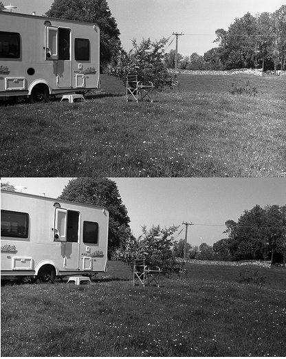

One frame taken right way up, one with camera inverted.
Most would hope for an even exposure regardless of speed accuracy. Hope yours will be free of these issues.

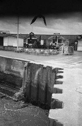

Apparently my viewfinder works in a very highly approximative way. I miss a lot on two sides of the frame. Any shot framed in a symmetric way comes out chopped on left and top. Please see the photo attached. I am sure I never frame anything like that. Is there any way to fix this, you think? I like the turret finder but I also like to be able to take my camera out without the external finder.

Hello Mah, what might be the case here is that the top of the camera is not precisely matching with the position of the view/rangefinder. This can be caused by an exchange of the top of the camera with that of another. I have seen a Zorki 4 where the viewfinder hole in the topcover did't match the position of the view/rangefinder. You can check easily if that is the case with your camera too.
How can I do that? As far as my untrained eyes can see, the viewfinder is well-centered in its frame. Plus, the rangefinder works perfectly and the focus area is right in the middle of the viewfinder... But is there any more specific technique to check this?
I don't reject the fact that this can be the case here (these are rather old instruments, and people may have done anything to keep them alive over years). But I don't give it a high probability either, because my copy is a rare export version produced only in 65-66 and all the details of the body correspond with that. The serial on the main body is 66, the leatherette seems to be of the correct type, all the scripts are in English and engraved on top body and the lens serial number is 66 as well. Maybe it is just too perfect to be true...
Hello Ron!
I just found out this is the normal parallax error of Zorki 4, that becomes much more visible at the closer distances. Apparently one has to use a parallax-corrected viewfinder with Zorki 4 to simulate the right framelines...
