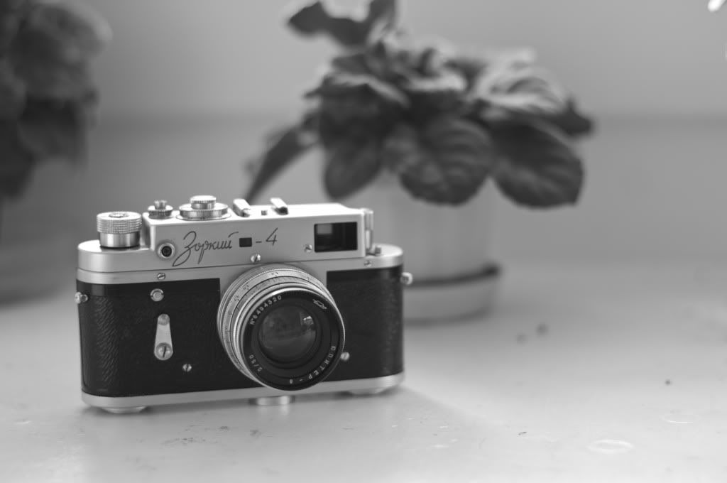

Zorki 4, exciting . . . and in need of repair.
9:31 AM
Mar 24, 2011
5
So my aunt asked my mom what she should get me for Christmas and my mother told her i was into cameras and of course she jumped on the internet and did some basic research. And well she told me that her searches lead her to Leicas. So she went to a local camera shop and had a heart attack. But the person she talked to there recommended a Zorki. And a quick trip to Ebay brought her to this.
I was pretty excited so i loaded a roll of film, brushed up on the sunny 16 rule and went out. Well after developing the first roll i noticed a few things.
1. i need to clean this thing, films kind of scratched.
2. The basic functions are all working.
3. my aperture ring seems to be off a stop

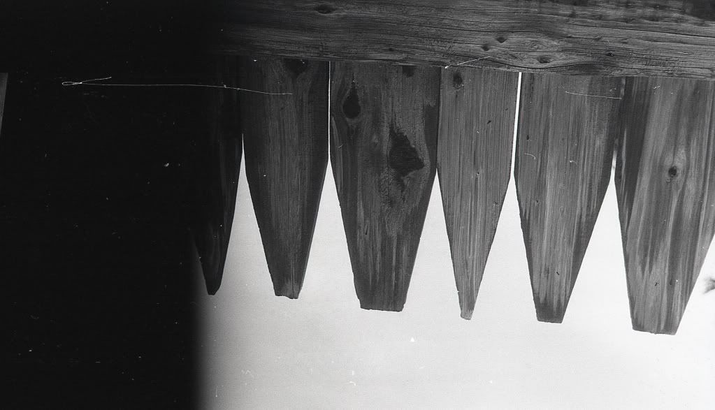

4. my winder is messed up. * actually it might be the shutter now that im looking closer at it. A few pictures do have double exposures over each frame but some of the pictures look like the one below . . . which could be the shutter right?
here are a few pictures to show both my joy and dismay.

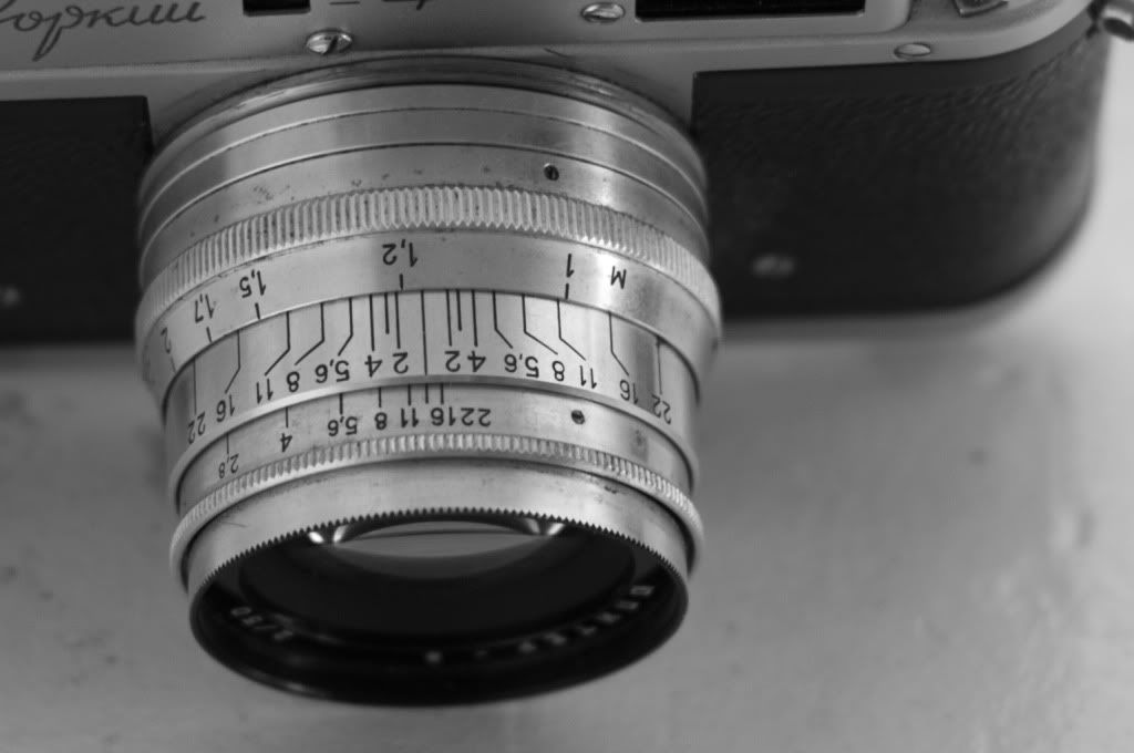

The first here is of the aperture ring not turning all the way to 22. So I'm not sure if that matters. It goes from wide open to stopped down to what appears to be 22 (but what do i know) So i think its just the ring, thus each stop is actually one down. Thus 16 is 22 etc etc.
And as for the winding issue (as seen below) is there a simple fix to this? Am i using the camera wrong? Any thoughts?

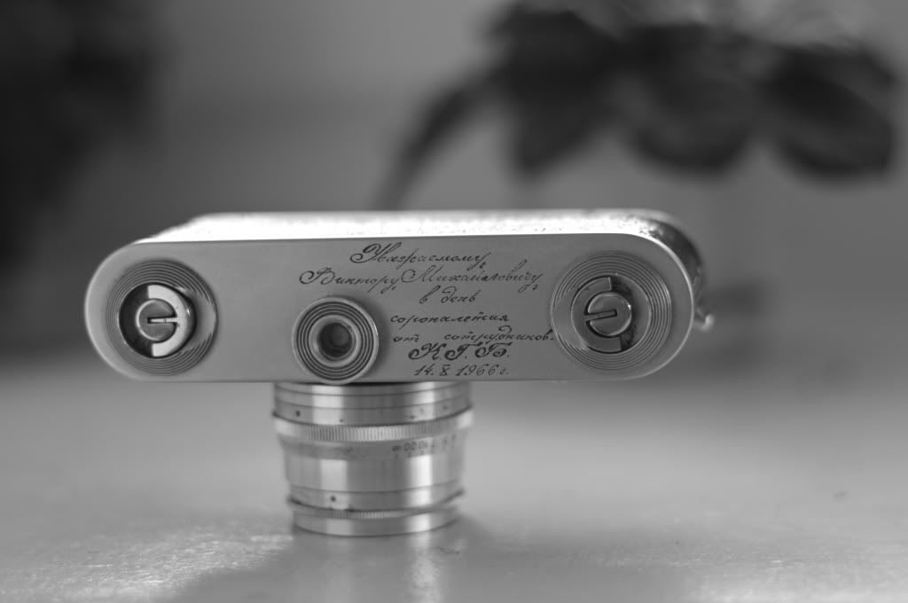

Also the inscription (according to my Russian friend at work) says
"Congratulations to Victor Mikhailovich, for 20 years of service, from the office of the KGB."

Welcome to RFF and that's a nice looking Zorki 4. The inscription may be fake, it looks like the lens is a '64, I'd doubt it took two years to get to the owner but who knows.
To correct the lens aperture, you will find 3 tiny screws around the aperture ring (you can see one in your pic). Loosen them a small amount, turn the ring until the apertures align correctly and re-tighten the screws - they don't need to be very tight so don't overdo it. Be careful when doing this, if you loosen them too much they'll fall out and you're almost certain to lose at least one!
I agree with batterytype that the scratches are not the fault of the camera. Is that shot you have posted either the first or last frame on the roll? If not, the uneven exposure looks like capping - caused by the shutter blinds not running at the same speed. It's usually a sign that a proper CLA is needed but sometimes you can get away with adjusting the tension rollers if things aren't too bad (look at the stickies at the top of this sub-forum for advice). It may also improve with use if the camera has been sat around unused.

As for the picture, the whole roll was like that, save for one picture.

Ok so, I set this camera aside and i haven't touched it in a while but i picked it up again and was looking through the fix stickies and i noticed that my shutter seemed to be functioning normally . . but then i remembered that when loaded with film the wind dial wanted to roll back a little bit. and sure enough when i pushed it back just a hair i got that shutter over lap.
