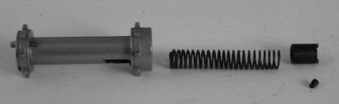

Tools (photo 1)
You'll need the following:
Large screwdriver with a flat blade of around 8-10mm.
Set of small screwdrivers with blades from about 1mm to 2.5mm wide.
A sewing needle or drill-bit of about 1-1.2mm diameter.
Pair of needle-nose or circlip pliers - they need to have fairly sharply pointed tips.
Tweezers - preferably jewellers type.
Precision oiler - a hypodermic & syringe (not too sharp!) is a good alternative.
Oiler - a needle or thin wire can also be used.
Thin oil - watch oil is preferable, "3-in-1 oil", "plus-gas" or similar is ok.
Medium grade oil - something regarded as a thin motor-oil would be suitable, silicone
is better still since it doesn't age much.
Grease - ideally silicone-based but thinner motor-grease could be ok.
Cleaning fluid - Lighter-petrol or, preferably, a proper watch/clock cleaning fluid.
A small paintbrush or similar to work cleaning fluid into parts.
Small containers to put fluids in and to store parts in.

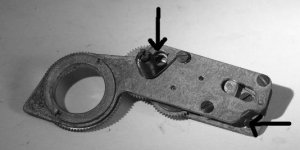

Slacken the two grub-screws on the rim of the shutter dial (photo 2). Don't remove them, just
undo them enough to allow the dial to lift off. This is easier if the shutter is cocked
and the speed set to about 1/2 sec. Trip the shutter afterwards though. While you're
near there, slacken the grub screw on the synchro ring too, setting the ring to "X" first
(photo 2 shows the screw clearly, below the arrowed one).

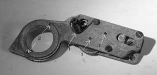

From the top-plate, remove the two front screws (photo 3), one rear screw (photo 4), one screw
from the accessory shoe (photo 5) and 1 screw near the wind-lever (photo 6). These are all
different so make sure you know where they belong!

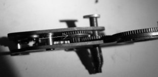

Under the disc are three screws - DO NOT remove them yet! Look next to the wind lever and you
will see a small hole (photo 9) by the three screws. Wind the lever until this hole passes the
screw hole on the top plate and hold it there (photo 9 shows the correct position). The lever
will be roughly at 90 degrees to the body at this point. Insert a needle or drill bit into the
hole as far as possible but using no force (photos 10 & 11). Release the wind-lever, it should
not return far from its current position. If the lever returns normally, you did not wind
far enough before inserting the pin, so go back and try again. You may have to release the
shutter first.
Once the pin is correctly in place, undo the three screws holding the drum and lever in place.
Lift the drum and lever, carefully, over the pin (photo 12).
Now lift the top cover off (photo 13). It should not require any force. Lift the outer end
of the wind-lever spring off the post (photos 14 & 15 and lift the spring and bobbin assembly
off as one. Take great care not to disturb the pin, if it comes out the spring WILL FLY and it
has rather sharp edges! You have been warned! You will also have to wind the spring back onto
its bobbin, which is tedious and fiddly. Set the assembly aside somewhere it won't get
disturbed.

Using a very thin oil, lubricate the points shown (photos 20, points marked "1" & 2). Oil
VERY sparingly, using an oiler or a fine needle to get oil onto the spot required. There are
the six pinion pivots (three on top, three underneath) and the escapement pawl pivot (photo 22),
the wind-ratchet (photo 23) and the spring. Lightly, oil the smaller pinion (gear teeth!) on
each shaft too. Oil the teeth ofthe escapement pawl, again sparingly. Excess oil will only run
somewhere it doesn't belong and attract dirt.
Using a medium grade oil, oil the largest, ring-shaped gear where it runs against the
O-shaped plate (photo 20, points marked "2"). Turn the mechanism upside down and note
the pin on the ring-shaped large gear. Turn this gear clockwise about 3 turns to wind
the mechanism, then release it. See that the mechanism runs smoothly and unwinds compeletely.
It should come to rest in about the same place each time and not stick at any point. Try it
several times, partly to check this and partly to run the new oil around. Once you're happy,
set the mechanism aside somewhere clean (like a zip-loc plastic bag) while the other work
is done.

The ring-gear pin (photo 25) is engaged by the speed-selector at slow speeds. The slower the speed
the further it winds the mechanism. The speed-selector sits a little lower on 1/125 or faster,
so it misses the pin for higher speeds. At 1/60 it doesn't quite get to winding anything, but
for 1/15 or less it does. The little cam sticking out underneath the mechanism (photo 24) is what
blocks the shutter closing-curtain (via a tiny lever) until the delay time is up. Photo 25 shows
the shutter cocked at 1/125 with selector (left arrow) missing the pin (right arrow). Photo 26
shows the same situation for 1/2 sec, where the mechanism has been wound some way (same parts
arrowed).

remove it and find out why! Once refitted Wind the mechanism a little, several times, it should
always unwind back to the exact same point (check the pin position, it should look like photo 25).
Now set the shutter speed to 1/60 by lifting the speed-selector and turning counter-clockwise.
Count your way through the notches to find 1/60. Cock the shutter by turning the film sprocket
in the direction of film travel (this is rough on the fingers!). Do this slowly and watch
the speed machanism as you wind. If anything fouls up, STOP and ascertain why, DON'T continue
to wind! When the shutter is cocked, the speed-selector should ALMOST contact the slow-speed
ring-gear pin. Fire the shutter and repeat with the speed set to 1/15 or less: this time the
pin should be engaged and the mechanism bewound up. Fire again and see if it sounds right.
Refer to photos 25 and 26 again to see how things should look.
Refit the flash-synchroniser once you're happy with the slow-speed escapement.

This part concerns the cleaning and lubrication of the shutter release and re-wind release
mechanisms. It assumes the top cover is removed.
The shutter release/rewind mechanism is held in place by one small set-screw (photo 29).
Before removing this screw, place a finger on the shutter release and keep it there!
Removing the screw without this precaution guarantees the parts will be launched into the
air! Turn the rewind collar about halfway so that the screw is more accessible. Remove the
screw then slowly release your finger. Retrieve the parts shown in photo 30 - the shutter
button and spring under it, the rewind collar, the shutter rod with 2 collars and a spring
around them. It's quite likely that this lot will be well gunged up and the lower collar
may not come out. If so, don't worry too much about it but beware of it falling out and
becoming lost. Dump the lot into cleaning fluid for a while. While it's soaking, clean
inside the tube where it all fits, using a cotton bud or similar, soaked in cleaning fluid.
This will also clean the gear intruding into the bottom of the tube. Lubricate the gear along
with the one it meshes with; use silicone grease.
Lubricate the cleaned parts with silicone grease and reassemble. Take care that the shutter
release rod is inserted the right way up - the narrowed part goes at the TOP. Make sure the
rod enters the shutter button properly, a little wiggling as you put the button back in may
be needed. Line up the L-shaped cut-out in the shutter button with the hole in the rewind
collar and replace the screw, hold the button down partway as you replace the screw. Make
sure the button and rewind collar operate properly. It's very easy to mis-align the cut-out
so that the screw locks the shutter button solid - you may need several attempts!

The restrictor gears sit in the lower, front, right-hand corner and can bee seen in photos 43 and 44
at the lower left. To access them properly, along with the roller pivots, remove the crate front as
follows: First, undo the four baffle screws (photo 43). The baffles will fall into the crate but
they have so little room that replacing the screws later is not difficult. Take care that they do not
move and cut into the shutter cloth parts. Now remove the four crate front screws (photo 44) and the
crate front. Carefully recover the baffles, noting how they fitted.
Clean the restrictor gears (photo 45) as needed and lubricate them with silicone grease. The shutter
will need to be cocked and fired to rotate these gears - depending on the stage of disassembly you
can turn the film sprocket to cock it (turn in film-travel direction!).
Lubricate the spring rollers sparingly, with the camera upside-down (photo 46) using a medium oil.
Make sure the oil goes between the moving parts - the thinner part of the roller is fixed. Cameras
that make a high-pitched zzzzzzzzzp sound when fired usually do so because these points are dry.
One final point to oil here is the shutter drum shaft. This can be accessed just above the shutter
curtain but GREAT CARE is required not to get oil on the curtain or damage it. If in doubt, leave
this part. You will need a very fine-tipped precision lubricator or hypodermic to get oil where
required. Photos 47 and 48 show the drum without the curtains in place. As can be seen, there is one
access blocked by a pin (photo 47), the other is not (photo 48) and can be used. The shutter must
be partially cocked to get this in position, and curtain damage is a risk when passing the oiler
over its edge. Use very little of a thin oil here.
Photo 49 shows the location of the bottom drum shaft pivot, which should also be lightly oiled. It
can be accessed by removing the lower spring cover (photo 50). Note the spacers under the cover,
they are not identical, fit as per the photo. Remove the shutter latch (the silver disc in the photo)
after noting its orientation. Be sure the screw holding it is TIGHT when replacing. Lubricate the
contact surfaces of the latch with silcone grease.
Photo 51 shows the upper roller pivots. These can only be oiled by removing the whole VF/RF
assembly from the top of the camera, a rather fiddly process.
