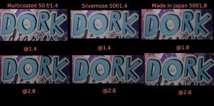

I decided to abandon any further cleaning attempts. I spent yesterday afternoon testing it against the 50f/1.8 MIJ and my old trusty silvernose 50f/1.4 and it performs just as well (and at wide apertures better than) in terms of sharpness and flare control as the other two lenses. I think any risk of damage outweighs any potential benefits.

Thank you. Here are the pictures that made me decide against cleaning it more.
And bokeh
