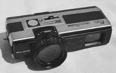

I was at a thrift shop today, came across a 110-format camera, the Fujica 350 Zoom, complete with hot-shoe mounted flash unit (the Fujicolor Strobe.) I checked out the lens zoom and focus, seems to be okay, needs a bit of cleaning. I ratcheted the film advance wheel, verified that the shutter fires, and the 3-position switch on top adjusts the aperture to 3 various f-stops; the film advance gear also turns; so, I'm hoping that, barring a light leak, this should be a functional camera. I picked up several rolls of 400-speed Kodak 110 Ultra film from Walley World.
Question about exposure; I don't know the camera's shutter speed or f-stops provided, so can't use a light meter. The 3-position aperture switch is labeled with sunny, partly cloudy and cloudy symbols, so that seems obvious; I just don't know if those setting were optimized for 100 or 400 speed film.
Also, the flash has an attached chart indicating aperture settings for each film speed and distance combination; but again the camera's f-stop switch isn't labeled with actual aperture values. Does anyone have any more information on this camera?
I'm figuring on running a roll of film through it anyway, but wanted to be more certain about the exposures.
The build quality seems first rate, and it has a remote shutter cable thread as well as tripod mount.
~Joe

110 film had a tab that informed the camera if it was ASA 80 or ASA 400 film. Early version of DX encoding. The camera should adjust for the film you put in it.
Right you are, Bill. I noticed this today that the sunny/cloudy indicator next to the 3-position switch moves over one position to the right when you insert a 400-speed coded cartridge.
