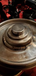

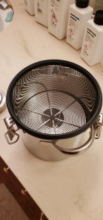

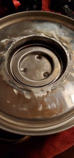

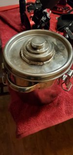

Here are a few images of my prototype 70mm daylight tank. It is the perfect diameter for the large 5m reels and it will take two! I used a 316 stainless steel lab grade locking container and a 35mm daylight cap. I had my buddy cut the hole and TIG weld the cap onto the main lid. He said that it shouldn't rust since he used a SS welding rod.
The lid has a thick heavy duty replaceable gasket. I'm going to try and burn through the remainder of the film I have left and develop it this weekend. I'm going to work on getting a spacer 3D printed when developing only one reel, but if you have a second reel, that can act as a spacer. My buddy said that he'll do more if people want one.
