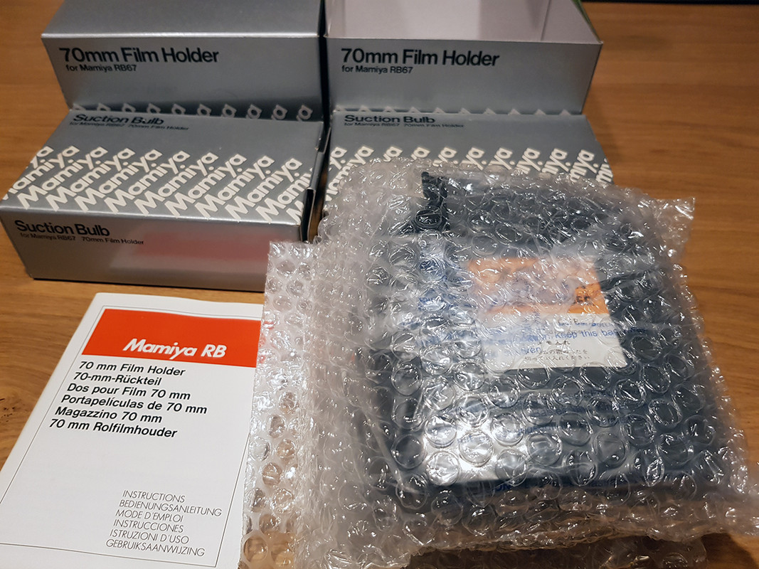

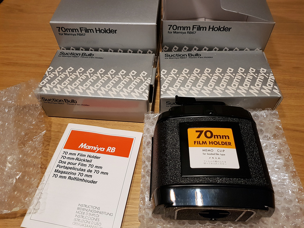

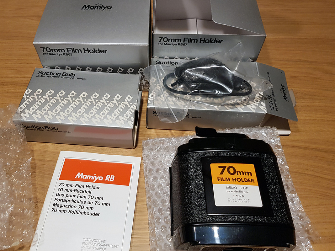

Ok so I have found a lot of 70mm backs for mamiya RB/RZ and mamiya universal camera systems all new never used in boxes. All of them come with faulty suction bulbs. The bulbs themselves need replacing but other than that they work great.On the plus side I have never ever needed the suction bulb. The film is flat thanks so there is no need in replacing them If anyone is interested i am willing to trade them for 70mm film. Just PM me.
