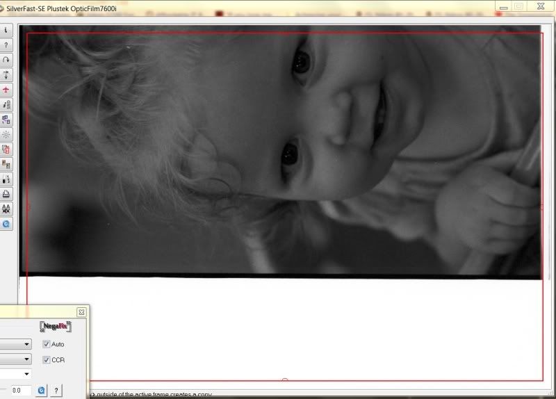

So my wife caught me by complete surprise and gave me a plustek 7600i SE for Christmas. :eek::D Thank you honey :) I've been putting it through it's paces for a couple of hours and have been very pleased with the quality except for one major problem. It's not scanning the entire negative! I always have one side of the negative not get scanned. Has anyone else encountered this problem? Or do you think it's time for a return?
This particular shot lost the right side of the image.

No it does not. I have done some further testing using the basic quick scan and am able to get full scans. It appears that silverfast is the offender. I was expecting to have to buy Vuescan anyway and this will probably just seal the deal...

I've scanned as positives and negatives in silverfast and it makes no difference. Using the quickscan method produces usable scans though. I expected that I would end up buying Vuescan so I will probably give the demo a try tomorrow and contact Silverfast support. If neither of these options works, than it might be time for a return.
