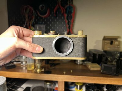

This was a sorry state non working Fed 1. It was laying around in my shelf for 2 years and it was the first camera that I tried to repaint. I did three coats of acrylic paint and one coat of clearcoat on this for testing (I noticed one or two layer of paint is more than enough to me.)
Do not mind the rough looking lens. It didnt came with the aperture engravings and it was the first object that I tried to repaint also. that particular Industar-22 lens is painted but not baked.
The FED 1 camera on the other hand is baked on every layer. Difference on baked - non baked can be clearly seen. I do have a Industar-10 fed lens which matches the look of this camera, with a beautiful black paint also (this time baked, and looking nice.) I feel the paint is a little bit ''too'' thick. but for the first try it is more than OK. clearly it's made to be a user.
Now gifted to my girlfriend so she can enjoy this.
My repaint tests will be continue. (I will take pictures of the camera with different lenses including the I-10 that I mentioned tonight.)
I didn't knew how to reassemble the camera particularly by making a new shutter curtain that is why I sent the camera to Oleg, okvintagecamera.
Clearly, he is a master on these and I do suggest his work to anyone who would like their camera to work nice. This particular one is the first camera that I sent to him and it's the most smooth soviet rangefinder I have ever used.

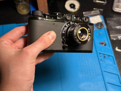

Did the reskin by my own after I got it and clearly not the best work it fits (I still look for some aki asahi / hugostudio kits that I can use on this)
More pictures please, don’t worry about the reskin material I have just used something similar on a 1932 Leica II.
Please, more info about the baking and how the paint was applied.
Various lenses can be seen. Industar 10, Voigtlander Color Skopar and Industar 12.

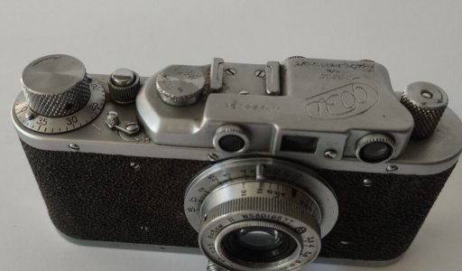

Another thing that I really like about Fed's is this; The Fed 1 type F; Notice the shutter release button and collar. Looks pretty much identical to old Leica's; (Leica standard, Leica 2. etc.) (look at the pictures side by side.)
(A Fed 1 type F that I recently got from eBay, shipped just today to my house.)
A Leica Standard, (picture taken from Leitz Auction website.)
Please take a moment and examine the shutter release button and collar on both pictures. Looks pretty much identical, compared to some late Fed 1, Zorki 1's which has this ugly conical shaped collar and a very weird striped button.
I'm not saying they are looking the %100 same, but good enough (to me, to me damn it...)

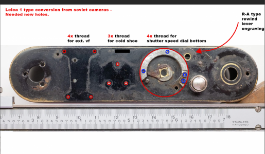

Some schematics that I made, please feel free to check them out.
Leica Standard's top plate assembly, screw holes and shutter speed mechanism part. The ring has an outer thread and the speed mechanism's shell fits there by an internal thread. It basically locks there (some of the guys here already know all about this, excuse me if it's too dumb to explain.)

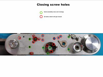

A Fed 1, how to convert this to a Leica Standard, if you want to make a nearly perfect thing, you need to dechrome this first (protect some places like the shutter speed ring which is riveted to main body etc.) but you basically dechrome it, and after you get the brass surface you use a black epoxy that you made, cover the non needed holes, and make new holes with a benchtop drill for specific screw sizes. Afterwwards you also add the screw threads. Remember that to this point it's still a brass chassis. then you paint it at your own liking (this and that bla bla.) and here you go. You have a nearly identical chassis (the specified screw placements will be made for your own sketchs etc, can be perfected but not possible by working on single unit, sorry not a millionaire.)
You just need to produce two parts, (machinated.) the shutter speed ring, and the shutter speed shell. Well I don't know how much they would cost on every single country or workshop, but I have asked a machinist locally who is specialized on making watchparts and that two piece will cost me 72 usd net.
You might ask that why I am making all this. First of all. I CAN, and this should be enough. I like the idea of producing a handcrafted, unique thing.
keep in mind that this will not have some fake leica branding engravings and stuff. I dont like that, let's keep that away from this mod.
I can create anything, making a fictional camera brand engraving, even put a serial number with 001 or something. It's all up to your imagination at this point (dont put weird symbols too...)
Second of all, You can still add stuff when you have money. Like producing a machinated shell for a viewfinder (identical to standard's one.) just too costly at this point so what I will do is to make a camera which looks like a Leica 1 but without that screwed vf, so basically making a really cool pocket size all stripped down camera which would be nice to paired with a Russar 20mm or a 28mm Fed (I dont have neither of them as today, but a man can dream.)
