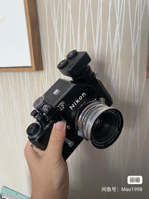

Excellent article. I previously owned a Schneider Xenon 50mm f/1.9 in DKL mount, which I adapted to my Nikon F system. While it delivered stunning image quality, I ultimately sold the lens due to its restrictive 0.9m minimum focusing distance. This is undeniably a remarkable lens - its classic bokeh rendering and critical sharpness in focus planes have recently made me consider acquiring the earlier M42 screw-mount version. Regrettably, I lost all sample images in an accident, so I'm unable to provide practical demonstrations.
