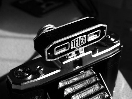

I have a Telex external range finder
It works well but it tends to be knocked easily out of alignment. It has a dedicated screw to align it again though.
