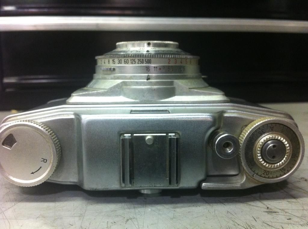

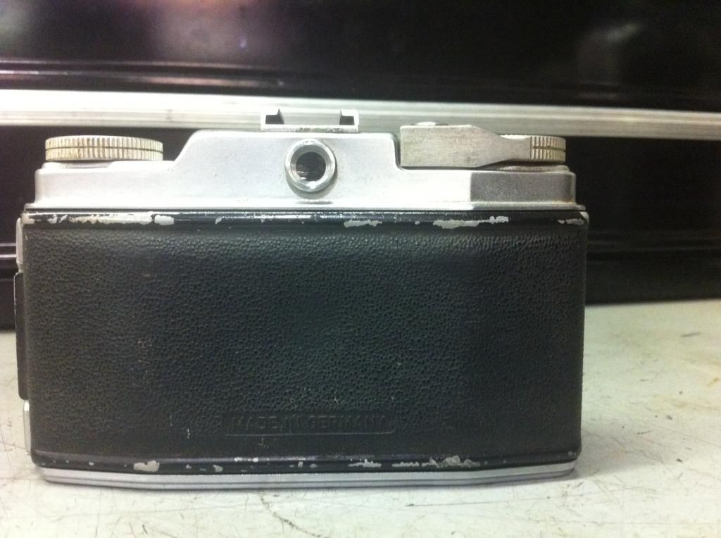

Heres the camera:
This was sitting in a bucket in a garage for quite some time. A co-worker brought the bucket in to work and let me have everything. I got a Polaroid SX70, Polaroid Land Camera 420, Olympus Pen EE S, Minolta XD11, Minolta XG1, Rokkor-x 1.4 50mm, 2 45mm, Vivitar Macro 75-205 f3.5 (something like that) this Agfa. All have been cleaned up and are working except this one. The Rokkor glass I got is in absolute perfect shape too which I was shocked to discover when I got them cleaned up.
