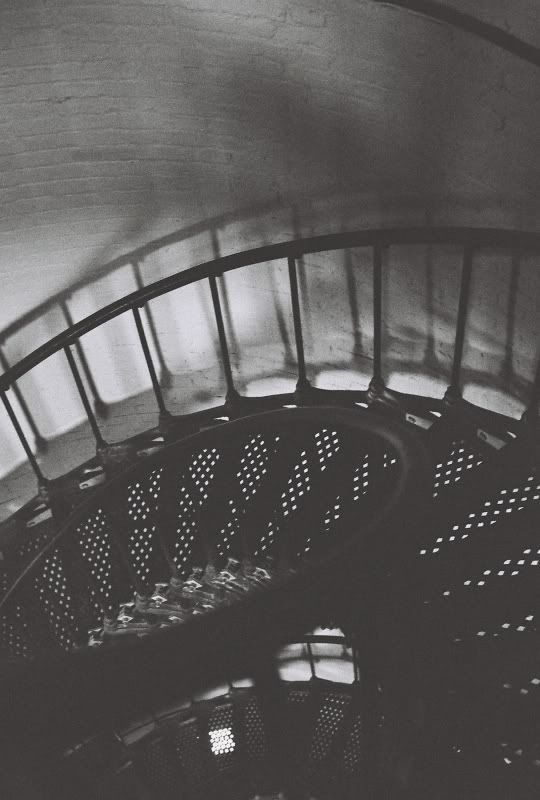

I like trying new and oddball films. Here are a few from my yashica electro 35gs.
Fuji Neopan 1600 rated at 1000 souped in rodinal 1:50 for 9 min 30 seconds with 30 seconds agitation every 3 minutes.
