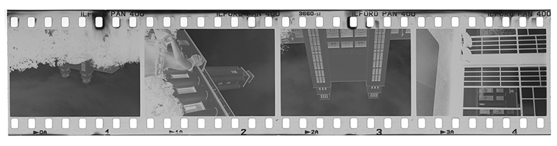

I have had it appear on lford PAN 400 135-36 too (all films of the same batch, with all my cameras, so the cameras are not the culprits and a friend having bought some Ilford PAN 400 135-36 from the same batch has this with his Leica M4-2 too), but always from frame 0 to frame 12 only (same for the friend). From frame 12 to the end of the roll it totally disappears and the film strip looks normal 100%.

As soon as it doesn't protrude into the images frames, no concerns. But it's quite close sometimes...
Below is a pic of what I get with Ilford PAN 400 :
Note : I have been processing my BW films at home for 35 years. I know how to do it. I always use clean steel reels and steel tanks and the same routine process. This is the first time I experience such a strange thing.
