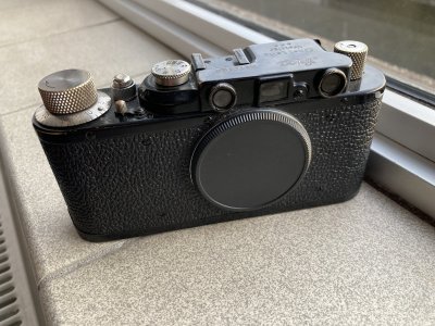

Just this afternoon looked at two black Leica IIs in two different shops. One had no diopter adjustment and when compared with a IIIc had less magnification. The other had a diopter adjustment and although I didn’t have a comparison it seemed 1.5x. The latter was a 78XXX so 1932 but it did not have the “O” on the mount and it did not have the back “window” so I think it had been back to the factory.
For what it's worth, I just looked at my II which has the rangefinder diopter lever and also my IIIc. To my yeye the image size in the viewfinders seemed about the same (i.e. no obvious differences), as did the rangefinder images. My II S/N is 829XX and has the "O" on the the mount.
I think that this confirms what I saw. If you have the diopter it is 1.5x. The view through the non-diopter II was very different to the IIIc. The lack of the “O” may just mean the factory changed the mount. I will be able to say more as I bought it!
The first can be a post-war conversion from a Leica l into a Leica ll or from a Leica ll into a Leica ll "new style". Was the engraving on top old style or new style? Often the early II's had a yellow filter built into the rangefinder. Why nobody knows. I would choose (for a user) the second one.
