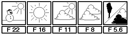

Of course, as far as going back to basics, nothing beats a healthy brain exercise using the sunny-16 rule. 🙂
works wonderfully for me...
