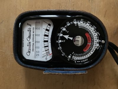

...I'm a little surprised there's been no mention of these yet:
Solid and hardy little things. No fuss. Incredibly helpful readout, especially if you're using older gear with pre-standardisation shutter speeds or apertures. Built-in zone system markings (with U and O representing Zone I and Zone VIII respectively). Good down to EV 3 at 100 ISO with no batteries. And, at least here in the UK, cheap and plentiful; I've never spent more than £10 on one. You might pay a little more if you want the Invercone adapter too, but I've literally never needed mine. The best bit is they're pretty small by meter standards - 95 x 54 x 21mm without the case - so it's easy to carry everywhere in a front pocket.
When things become too dark for the Weston, I pull out an iPhone app. But in 99% of scenarios, the Weston gets things done.

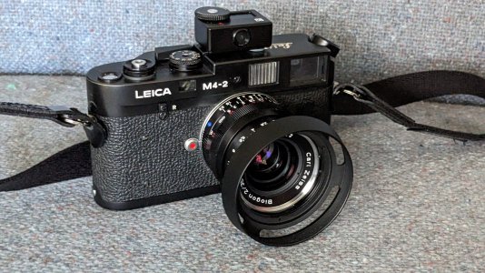

On my Nikon S3 2000 and Leica M4-2, I use a Doomo Meter S on each. It’s very compact, USB-C rechargeable, and reasonably accurate.
Virtually all old Weston meters found in the US are dead. I've seen a few that responded to light but were several stops out of calibration. I have a Master V that was rebuilt by Ian Partridge, but honestly it is too expensive for what it offers. Compared to a modern meter it is not very accurate, has poor low light sensitivity, is delicate, and too expensive for one that has been serviced to make it usable.
I've fixed a few myself over the years. Claims of weak or totally dead selenium cells are usually overblown (although it does happen). Usually it's just oxidised contacts, and cleaning them up and/or resoldering them brings them back to life. My absolute favourite is when people say they're not accurate when they've set it to the wrong film speed; a Weston I and II needs to be set two notches lower than the ISO (Weston 64 = 100 ISO), later ones are one notches below (Weston 80 = 100 ISO). You'd be surprised how many "inaccurate" Westons are just down to that issue.
I find the IV and V are most problematic, as the bar that traps the needle to lock the exposure is often a source of issues. The III is a sweet spot in build quality and readability, I find. Other than the revision in Weston Ratings, there's not much difference between that and the II other than the readout is a bit faster to decipher on the III. Either one in good condition makes a great meter.
The real problem is smashing the front glass and damaging the needle. I've only done that once before - had one in my pocket while moving heavy stuff around - and felt like a complete idiot. In every day use it's never been a problem.
