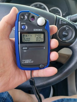

Thank you everyone for all the the info you provided! I ended up purchasing a Sekonic L-308X-U. It arrived a few minutes ago, so I'm still trying to figure it out.
My reasons for picking this particular light meter were because of the (advertised) low light capability and the power supply (one AA battery). Also, it has an on/off button.
I'm going to compare it to a camera I know has a good meter (R6) before loading any film in one of my cameras.

It's pretty simple really, just follow the directions and after a few uses it will be second nature. I like that it shows the exposure settings in both Shutter/Aperture or EV as I have a Hasselblad and a few non metered 35mm cameras. I gave up on the lanyard and just keep it in my pocket.

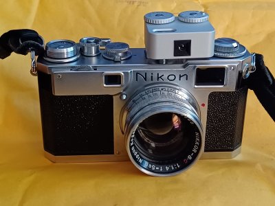

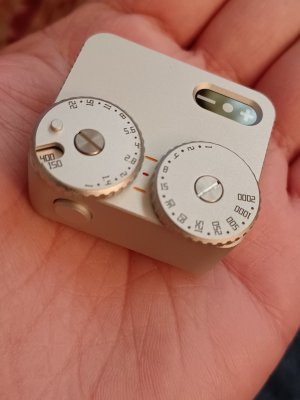

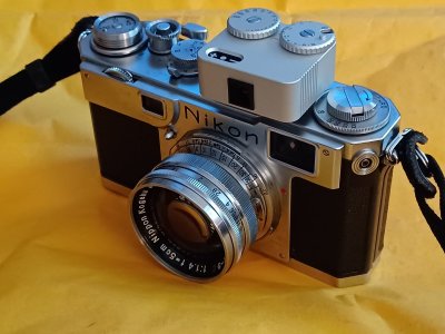

I ended up buying this tiny meter as well. It will probably end up living on my S2.

I have both the TTArtisan and Reflx Labs meters (and eventually will do a YouTube video about them.) They're both solidly made and, while it's impossible to test a meter for actual "accuracy" unless you own a lab-grade calibrated light source, I did try them under low and high light conditions and both were within 1/3 stop of my Minolta Flash Meter IV.
I did notice with the TTArtisan meter that the green "correct exposure" LED stays on over a range of nearly 1 stop, so you have to saw it back and forth to get it in the center of its range if you're picky. Re someone else's comment above, the ISO dial on mine is very thickly damped and seems unlikely to get turned by accident, although of course anything is possible.
The Achilles' heel of both of them is visibility. The Reflx Labs meter has an LCD readout that's easily readable in bright sunlight, but unreadable in very low light (there's no backlight). The TTArtisan meter's LEDs are easy to see in dim light, but get completely washed out in bright sunlight; meanwhile, in very dim light, the print on the calculator dials is small enough to be hard to read, unless your eyes are better than mine. They're both usable under most "average" light conditions, though.
I predict we'll be seeing a lot more of these basic-featured, inexpensive-but-accurate meters in the near future, thanks to advances in the chip-making industry. It used to be that the selenium, CdS, or silicon light sensors used in meters weren't very well standardized, so good meters needed individual component selection and calibration to produce accurate results over a wide range. Now, chipmakers can make light sensors that roll off the production line producing almost completely identical readings, with no individual calibration required.
Meanwhile, a powerful microprocessor, such as the STM32L0 used in the TTArtisan meter (ST is Europe's second-largest chipmaker; I couldn't find out what chip the Reflx Labs meter uses because I didn't have the right size Torx driver to disassemble it) does all the heavy lifting of voltage regulation, sensor reading, measurement logic, and display output at a very low cost -- a single STM32L0 retails for $2.66 on Alibaba, and I'm sure manufacturers get better prices in quantity. Other than the light sensor and the STM32L0, the TTArtisans' nicely fabricated circuit board contains a startlingly sparse handful of components: a few surface-mount resistors and capacitors, the two potentiometers connected to the dials, and the readout switch. The Reflx Labs meter is bound to be simpler yet, since it uses up/down switches instead of "pots."
Either of these seems like a good solution for "meterizing" an older camera or subbing for a dead built-in meter, and there are other choices I haven't explored, probably all with similar innards...
How are you finding it? The price point is obviously appealing, but early reviews when it first came out suggested it was really easy to accidentally change the ISO without realising. Have they fixed that yet?
So far it's been working well. I checjed it against my Sekonic L398, and it provides the same measurements.
As for the ISO dial being easily switched, it's not bad. The dial sits recessed and is not easily moved. My only gripe (no fault of the meter) is that the numbers are tiny. They are very difficult to see at least for me.
A neat little feature is that you can move the hotshoe mount to either the left or right to accommodate your camera.
