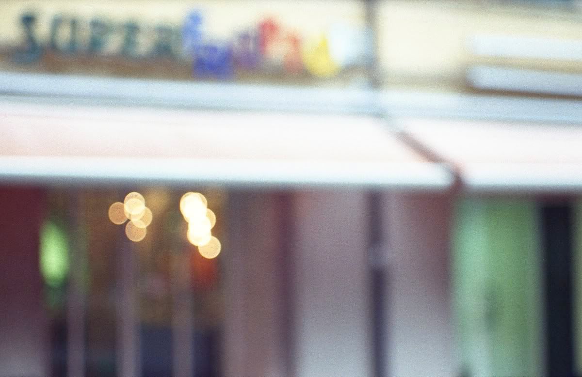

in an out-of-focus "bokeh-test" i see some little black dots in the light circles: are those dots my little bubbles?

My curiosity is about that little black points in the out o focus lights on the left: they are in two lights and are absolutely identical, so I thought they was caused by the lens, but of course it's possible that one of the points is the reflex of the other, created by the window of the shop.

The little black dots look like defects on something close to or in the front of the lens. Could indeed be the bubbles. You should be able to count and match the pattern 🙂
For example, this was shot through a mosquito screen (i.e. behind her):
There are also some example of people glueing paper shapes in front of their lens to have funny bokeh shapes (like hearts for Valentine's).
Otherwise, ignore the bubbles and be happy about a great lens 🙂
