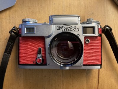

I've used Aki Asahi's stuff a couple of times. It's really well priced, is delivered surprisingly quickly considering it's coming from Japan, and looks great. For example, my 2020 lockdown project of a Kiev 4A restoration used Aki Asahi's leather in an on-theme Soviet Red, and it came together nicely:
Fitting new coverings on Leicas with both the slow speed dial and self-timer is a bit fiddly, but take your time and follow the instructions and I'm sure you'll be okay.
