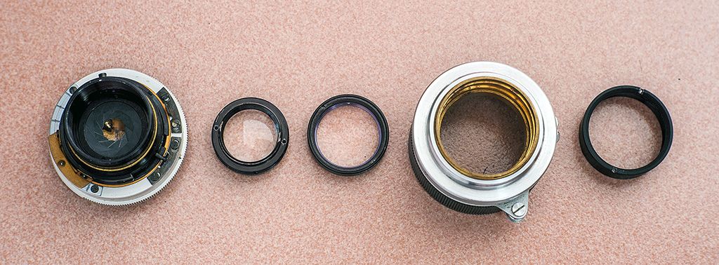

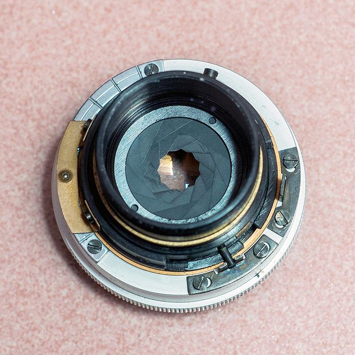

the black thingy seems to be behind the aperture assembly, that is I don't think you need to remove the front assembly but open the lens from the back which is very simple. Some instructions can be seen here: http://nelsonfoto.com/SMF/index.php?topic=24501.0
A lens spanner will help, possibly isn't necessary for the first ring and certainly not for the first lens that doesn't have to be removed from it's housing but screwed off with it, but for the third block which is recessed. In case you try by yourself and need more detailed instructions ask for it, I may try to help. To remove some haze that is recurring I have to open my copy regularly anyway, and I just opened it to check if there was some kind of ring just behind the aperture assembly that could be broken and the culprit but the one that's there is wider, I don't think this is it
the order of disassembly from right to left:
the last one to remove is a recessed and the one that will be difficult to remove without a spanner ( for having been removed often quite some paint loss around the notches on mine )
the ring behind the aperture assembly
Wow, these are some great instructional photos. Thanks for the help Kuuan!! However, I think I'd be better sending it off for repair. I don't have the proper tools or experience.
