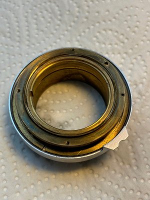

Hello,
I got a copy of this wonderful lens but am stuck during disassembly. I files a spanner wrench to fit the slits in the locking ring and soaked it in WD-40 to convince it to move- no success.
Just to be sure: we are talking about the slits which are circled in red on the picture (and the counter part on the opposite site)? Any ideas what I could try?
Thank you!
Bastian

As an update to this old thread, I also tried to relube the helical on a recently bought Canon 1.4/50 mm LTM Type II and also failed to loosen the retaining ring.
After trying for some time I considered it may not really be necessary to get the helicoid out and stopped before I could damage anything. I had already soaked the lens in lighter-fluid for about an hour, worked the helicoid and resoaked it for several times to get the old grime out of the helicoid and now just let it dry.
When focussed to infinity there is enough of the helicoid-threads accessible to apply fresh lubricant (I used Klüber Catenera KSB 8, a dampening-grease of medium viscosity, which turned out to be just right. You might even go higher in viscosity if you like). I generously brushed grease in the threads and worked it into the helicoid by focussing back and forth, reapplied grease several times and didn't forget to also work a little into the slit under the retaining ring.
This worked just fine and the lens focusses like new. So if you have trouble removing that retaining ring, it may be a problem that can easily be ignored.
