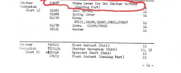

The 2nd curtain stopped before reach/pass the gate, the metal bar is visible, need 2-3mm further travel to reach the 1st curtain. I can see the 2nd curtain brake/stopper, but it seems not adjustable. Any suggestions how to adjust the 2nd curtain to travel further? BTW. All rollers are CLAed, it is not a need CLA saturation. Thanks

I adjusted the 2nd curtain stopper (possible the 2nd curtain brake, the one I circled on the photo) holding screw, the 2nd curtain is able to travel further. While Canon 7 is a capable RF camera. the build quality and design are on the cheap/mass production side. The service manual has minimal information and there is no other manuals available to understand how the shutter works. It is a Leica type shutter, but cheaply designed and made.
The circled part is the 2nd curtain level according Canon VIT, VIL, and P service manual parts list. If this part stuck or too tight may cause the 2nd curtain stop before passing the film gate and reach to the 1st curtain.

First you have make sure the camera is CLAed, your issue could be related to camera need CLA. If CLA does not address the issue, then adjust the parts listed above
