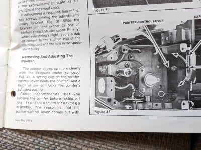

1000033572.jpgso the area circled in blue should be where the lolypop looking needle should sit but it seems to not be there. I think the one you circled is attached to the actual meter itself and moves with the change in light.
This may help. The needle is circled in red. It's attached to something inside of the round meter module. I can't see what.
