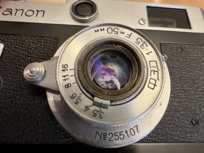

Hi all i'm new here so be kind !
I shoot film with 35mm 6x6 and 6x7 but recently I got a hankering for a rangefinder camera – upshot is that I have a Canon P on its way. Looking at lenses I normally shoot 50mm, 35 and occasionally 28. I am looking for a 50mm for the P and was wondering how the forum rates the Industar 50mm, also is there a fit issue when collapsed on the P ?

The Industar-50 50mm F3.5 is nice, inexpensive, and compares well with a Leica Elmar 5cm F3.5. "The Catch", the ex-USSR lenses are made to the Zeiss standard. Even the F3.5 lens will benefit from adjusting the shim. You do get lucky sometimes. Probably "50/50" on the I-50 and I-22.

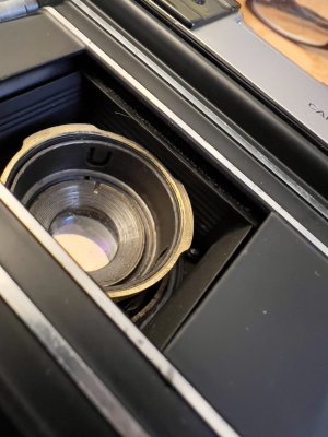

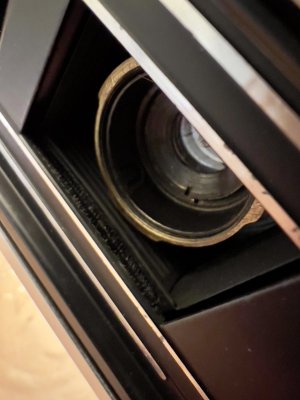

The Canon P and Canon 7 have Light Baffles internally, and collapsing a lens can hit them. Even the Canon made collapsible 50mm F1.9 will hit them.
Best advice: If you get the collapsible, open the camera up and hold the shutter open. Collapse it slowly and watch for an issue.

I followed me own advice...
The Locking Flange on an Industar-50 will rub against the light baffles on the top of the camera as you collapse it.
