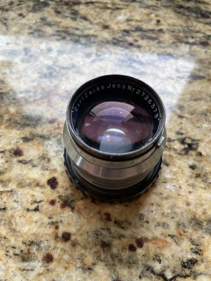

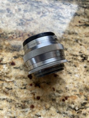

Well, folks, the Sonnar oddity (referenced here in previous posts) arrived…
Some observations:

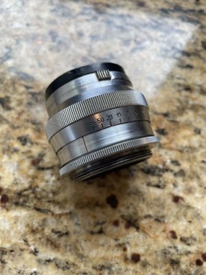

- Despite the focus scale suggesting that it focuses in the Contax/Nikon RF direction, the lens does indeed focus in the Leica direction. Thoughts?

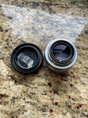

- The focus requires adjustment and it seems the screws taped to the bottom of the rear cap it came with might be the reason the lens will completely come out of the barrel if you turn it enough.
- Aperture ring needs adjustment — will only engage if you pull up a little — I was initially worried that someone had removed the iris for parts.
- Once adjusted, it seems the focus range from close focus to infinity will be about 270 degrees (judging off distance scale)
- The glass is surprisingly nice - minimal cleaning marks on the front and the rear element is nearly pristine. There seems to be haze and/or coating deterioration on the front side of the rear triplet that might need to be wiped off completely for best results.
I think I’ll be sending the lens to Don for an overhaul — hopefully internally nothing is damaged that will prevent this. I’ll be sure to ask what he thought of the quality of the internal construction and if he’s seen one like this before.
If anyone has thoughts on this lens, or has a similar example, please comment below.
Attaching some photos of the lens at infinity and close focus to show how misaligned it is.

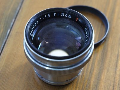

Why is this Sonnar 5cm f/1.5 strange? Well because the serial is from the 6th batch of Sonnar 5cm f/1.5 dating back to 1933 but the body clearly is made around 1947/1948 by Carl Zeiss Jena. Furthermore the lens has a valid CZJ name ring with a red T. The lens seems to be coated. The 1933 lens were uncoated. Well after WWII Zeiss offered to add coating to your uncoated lenses. So maybe the original (uncoated) glass was coated after the war. I have seen some of those lenses. In most cases it looks like Zeiss engraved the red T on the original name ring to show the coating. BUT this is not the original name ring! You see 1933 the engraving on name rings was a tiny bit different. I did not even talk about the font or spacings. I just say that they use "Nr" instead of "Nr." on the ring 1933.
So it is fake? Nobody knows. The serial is legit. The body is legit. The name ring is new. But that does not rule out that the glass inside this lens is the original v2 glass from the old 1415751 lens. The story behind this might be easy to explain. The original lens might have been damaged to a point where Zeiss saw no point in repairing it. It was easier to move the glass to a new lens. The old name ring would not have fitted this East German Sonnar 5cm f/1.5 body from 1947/48. So they engraved a new name ring with the old serial. They added coating to the lens to give it the latest treatment. So this lens might contain the old v2 glass in a newer body. Unfortunately this is only a theory of me. And nobody knows if Zeiss could salvage the old lens elements into this newer body. Maybe it was not possible and they just dumped the old 1933 lens completely in the trash bin and just engraved a fresh 1948 Sonnar with the old serial to give it to the previous owner.
I would call such a case Out-of-Time Sonnar. A Sonnar where serial and body does not match the production time.

This is another interesting one. A legitimate wartime LTM mount (lowercase „m“) and what looks to be a legitimate pre-war lens block. The curious thing is the beautiful multi-colored coating of the lens and the far too early serial combined with a red T.
I have a 201x coated and T labeled Contax mount Jena 5cm 1.5 which some people believed to be much too early a serial number for a factory T designation.
The optics of this LTM version are even older. So the lens block does not match the focus mount, and the coating and T designation is very early. Maybe the lens was custom coated and engraved after the war and transplanted into a LTM mount.
Either way, a beautiful lens.
