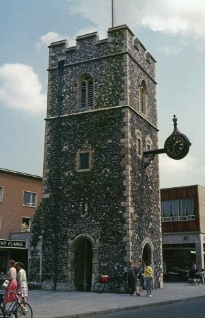

impressive (my slide scans have some of the same issues, but not as severe) - did you use a scratch/spot remover overall or deal with each point separately? -- approx how long did this one take and did your final image maintain overall resolution and file-size?A number of people have suggested FastStone Image Viewer and I have to agree. Although I have several other programs I can use, my go to is FastStone. A while ago I scanned a large number of slides dating back to late 50's - early 60's (Dimage Scan Dual IV) and quite a few needed quite extensive work due to fungus and other issues due to long storage. I used Fast Stone almost exclusively to "fix" the problems.
Here is a scan before and after after processing with FastStone,

Firstly I used the dust/spot removal when scanning the slide using the Scan Dual software. Then processing the image in FastStone to correct color, adjust perspective and a bit of unsharp mask, finally touch up remaining issues with the clone/healing tool. Total time on this image was around 15 minutes. This is the final image:-impressive (my slide scans have some of the same issues, but not as severe) - did you use a scratch/spot remover overall or deal with each point separately? -- approx how long did this one take and did your final image maintain overall resolution and file-size?
