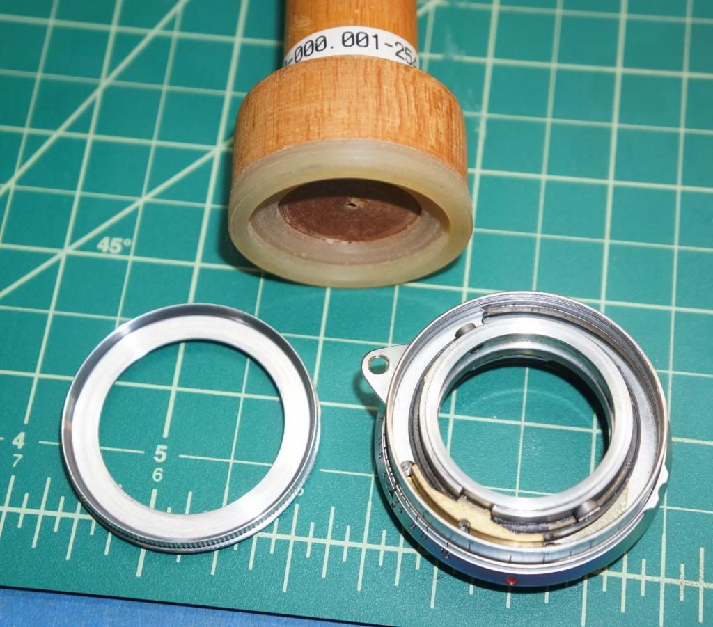

Thanks for your reply. This is where I’m stuck. Where is this stop screw and how can I reach it? Looking on the mount I can see three tiny holes where I can see the end of three screws but they are out of reach, because they are mounted from the other side.
Well I know this is a day late ... but I figured I may as well help if I can. Leica made a tool for everything .... you will see in the picture the tool that is used for the lens. It is a very stubborn piece to unscrew .... Dont use big pliers !! Find some rubber and when your twisting the screw top off you may want to pray for extra strength !! It is screwed on extremely Tight !!! Hope this helps .... ThirdMan
