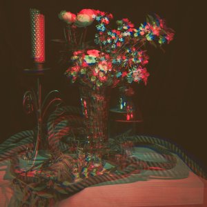

For some reason I had to try, next time I'll bring a real tripod and not a monopod 😀 Trichromes taken with leica m9m
The scene:
The result with three colour filters:

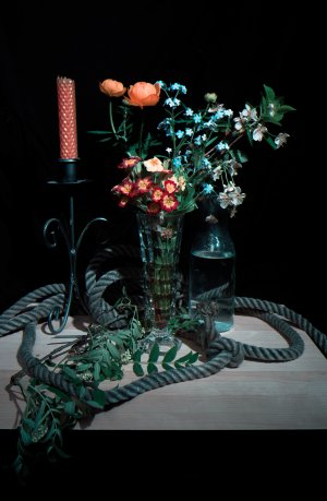

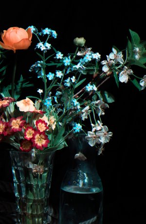

And an other one:
And the result again:

It's three exposures through different filters. Red, green and blue. Then they're added to those channels in postprocessing (photoshop in my case, but gimp or what ever works). You need to adjust the individual frames exposure a little due to filters not being identical in their "darkness". In my case these are cheap plastic filters, generally using good quality filters would result in better "true" trichromes, these have a bit too much overlap.
Overall quite straightforward process, but quite a bit of work.

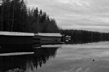

Still very much experimenting and fooling around. Bit too windy to get it right (but I do like the waves of colour). This rock is where I learned to swim and my eldest kids learned to swim, as did my mother and grandmother. I live around 500meters from here these days.
Wonderful picture, and more importantly the story.
