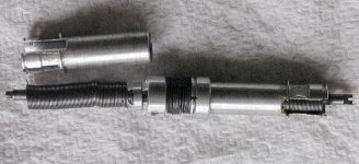

micromoogman, I posted on your thread in the FSU forum (so you lied about the camera being a Kiev 4!!). I attached a picture of the partly dismantled spindle (from a Kiev), which I've also attached below, but I've inverted it so that the right of the picture corresponds to the right of the camera. If you PM me your email address I'll send you a text file of the notes I made when I stripped a Kiev 4A (so that I could get it back together again).
I really do not think it is a practical possibility to replace the springs (I'll explain if you want), but IF the centre spring has simply come unhooked you might be able to fix it.
Steve.
Steve.
Heh, no I have a Kiev from 1959 that I was thinking to take the parts from. I will, if not the re-hooking works, use the lower drum+curtain from the Kiev. That Kiev is just as good as my COntax was so it's really stupid.
