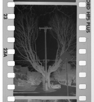

At 93 years old this camera has no right to be working at all, but still it does. Curtains are good and the shutter is (more or less) consistent. It needs a cleaning and lube for sure though, and there are also a couple of problems.
First and foremost, the frames are slightly crooked and misplaced (see photo). Is this something that can be corrected in the course of a normal CLA, and If it can, can it be done without the complete disassembly of the whole shutter. I ask because I understand that these cameras are the simplest Leica's ever made and good candidates for careful newbie technicians. However, I don't feel confident enough in my abilities (nor do I have the tools) to completely deconstruct and rebuild a FP shutter to spec. If that's what's needed then I'll pass it off to a professional.

Frame_examp.png and (more or less) on time.
The film cassettes were designed and re-designed more than once since your camera was built. The positioning of the film changed somewhat over time relative to the to- of the cassette and that may be what you are seeing. Try loading a film into a genuine Leica cassette using the cassette's own spool. The may show that the camera is still correctly aligned. In that case just live with the modern film error.
Bill
"Everybody who uses these older Leicas have noticed this issue. Not just one person. That's one reason I use the original Leica FILCA brass cassettes in my Leicas. Some will fix this issue by placing either cardboard shims or felt between the bottom of the cassette and the bottom plate in order to raise up the cassette.." New film cassettes vs old Leica cassettes - skewed negatives?
According to "Melvin" on RFF: "It's easy to correct. You just put some felt in the latch on the baseplate where it touches the cassette. Cut a little ring. You don't need glue, just press it into place."
Eric is absolutely right, of course. To follow the purist advice, you just have to buy at least two FILCA cassettes (cca 40$) and an original ABLON (cca 250$). Alas, Leica Standard itself can be bought for cca 300$. Anything else is cheating. With a small ring of felt - or even with upper lid of an used modern plastic film cassette - you might get the same result... Though, if you are a true Leica fan, you will not be satisfied with efficient improvisations. Been there, done that: I have 23 FILCAs and 2 ABLONs!
It has been a long time since I bought an ABLON and original early Leica cassettes. An ABLON then cost maybe EUR 5 and original cassettes 3 pieces for EUR 10. But times change. You may be able to make an ABLON yourself. Replacing the cassettes is more difficult as the newer Leitz cassettes do not fit well, resulting in showing the perforationholes in the image.
