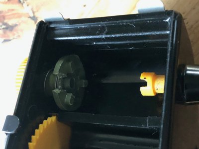

In my experience, an unmodified Alden 74 works very well with the newer Leica IXMOO cassettes as well as with the Nikon S or F cassettes and with factory load cassettes, but not as well with the older (taller) Leica FILCA cassettes. In particular, getting it to close the FILCA was a hit or miss proposition. I solved this by notching the disk in the Alden that contacts the bottom of the FILCA. With the black knob of the FILCA in the notch in the Alden it closes the FILCA flawlessly.People (Bill, dotur, and Erik in particular) thank you for clearing this up so quickly.
As it happens I have 2 of the early brass Leica cassettes, I just didn't use them because the loaded bulk loader I had wouldn't close them. I'll try it in my Alden loader, which works perfectly with the newer Leica cassettes as well as the Nikon F cassettes. Regarding the ABLON, I'm old enough to remember when film came pre-trimmed for the Barnack Leica's (as well as when ALBONS were almost free) so I think I should be OK trimming off the top third of the film by 4'~5" or so.
The other solution I found was the Watson 100 which has a removable shim to work properly with the taller FILCA and with the shim removed to work properly with all of the other cassettes. Unfortunately the fit and finish of the Watson 100 are not comparable to those of the Alden 74.Thanks Doug, That is extremely helpful information. As it happens I also have a Watson 100 and never realized that gray bit of plastic that sometimes fell out was in fact intended to be removed for use with FILCA cassettes. I've Just downloaded the manual from Butkus
Thanks! That's good to know. (I just confirmed that my Watson 100 works without the shim for a Kodak Snap-Cap cassette.)My Watson is missing that shim, but it still works okay for loading standard 135 cartridges without it.
